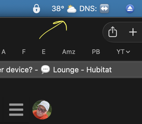

I do this on my the Macs in my house. I use an app called "OneThing" to put a string using emojis that tell the current outside temperature - I have an Ecowitt weather station in my backyard, the current sky weather conditions - scraped from the closest NWS station - and whether I currently have Raspberry Pi PiHole activated. It looks like this on my task bar.
On each Mac is a shell script that runs via cron every two minutes that uses curl to grab the current state of two devices (using the Maker API). The jq utility breaks the xml down into shell variables and then I construct the string and call OneThing. It is a total hack? Yes, in the best old Unix programmer sense of the word.

Would you please consider sharing a guide to implement on a Mac? The built in Weather icons are boring.

Here's the write up.
How I display current temperature, conditions and PiHole status in on my Mac task bar.
Parts of this Rube Goldberg Machine:
-	The “One Thing” app from the Mac App Store
I have a virtual device that is updated by an Ecowitt weather station and some rules that round the temperature since I don’t find tenths of a degree very interesting. The device is called “Backyard” and it’s device ID is 1112.
I use the Precipitation and Weather Monitor for NWS Data app available here on the Hubitat Package Manager and set it up to get the weather observations from Dulles Airport which is quite close to me. That’s gives current observations such as “Partly Cloudy” etc. And it’s device ID is 2395.
I have a shell script which I’ll share that uses MakerAPI calls to get the current state of those two devices. These are provided in XML format and need to be parsed. There’s a program called jq that will do that for you. Homebrew will allow you to install it easily on your Mac.If you don’t have home-brew first install it. It’s easy to find instructions online. Then in a terminal window type brew install jq.
The shell script.
This script is called in set-menubar.sh and it lives in a directory called scripts in my home directory. I’ll paste it below with the maker access token redacted. You’ll need to put your access token in and edit for your device ids to get the current contents of your devices.
There’s really nothing magic about the “pretty icons” as they are simply unicode icons as you’ll see in the script below.
To make sure that it is never more than two minutes out of date, it runs every two minutes as a cronjob. Again, since MacOS is a variant of Unix all these capabilities are out of the box.
$ crontab -l
1,3,5,7,9,11,13,15,17,19,21,23,25,27,29,31,33,35,37,39,41,43,45,47,49,51,53,55,57,59 * * * * /Users/jay/scripts/set-menubar.sh > /Users/jay/scripts/menuerrs
That’s really about it. As I said it’s a kludge, but one that has run reliably for 4 years or so. And if you don’t use pihole on your network it’s easy enough to just take that part out.
