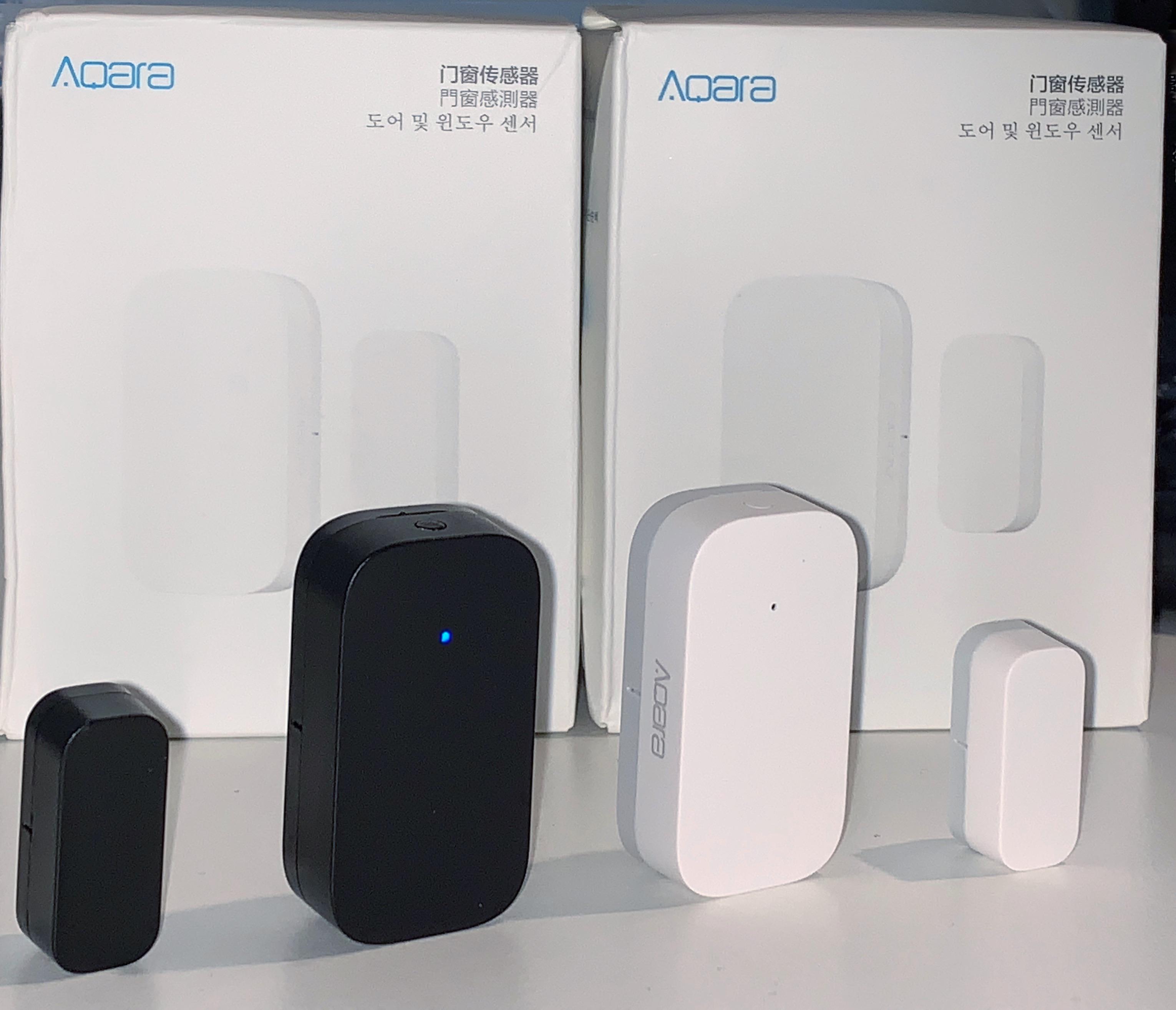

Depends on the skill level of the person doing it. I've seen spray painted contact sensors that looked really good. There's been examples posted by others here. Here's one that I found a while back, where they took the sensor apart, sprayed the plastic and then put it all together again.

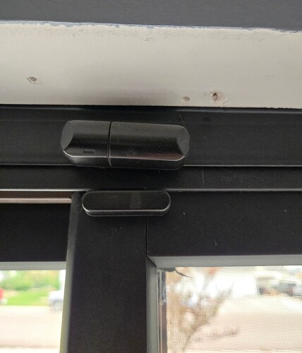

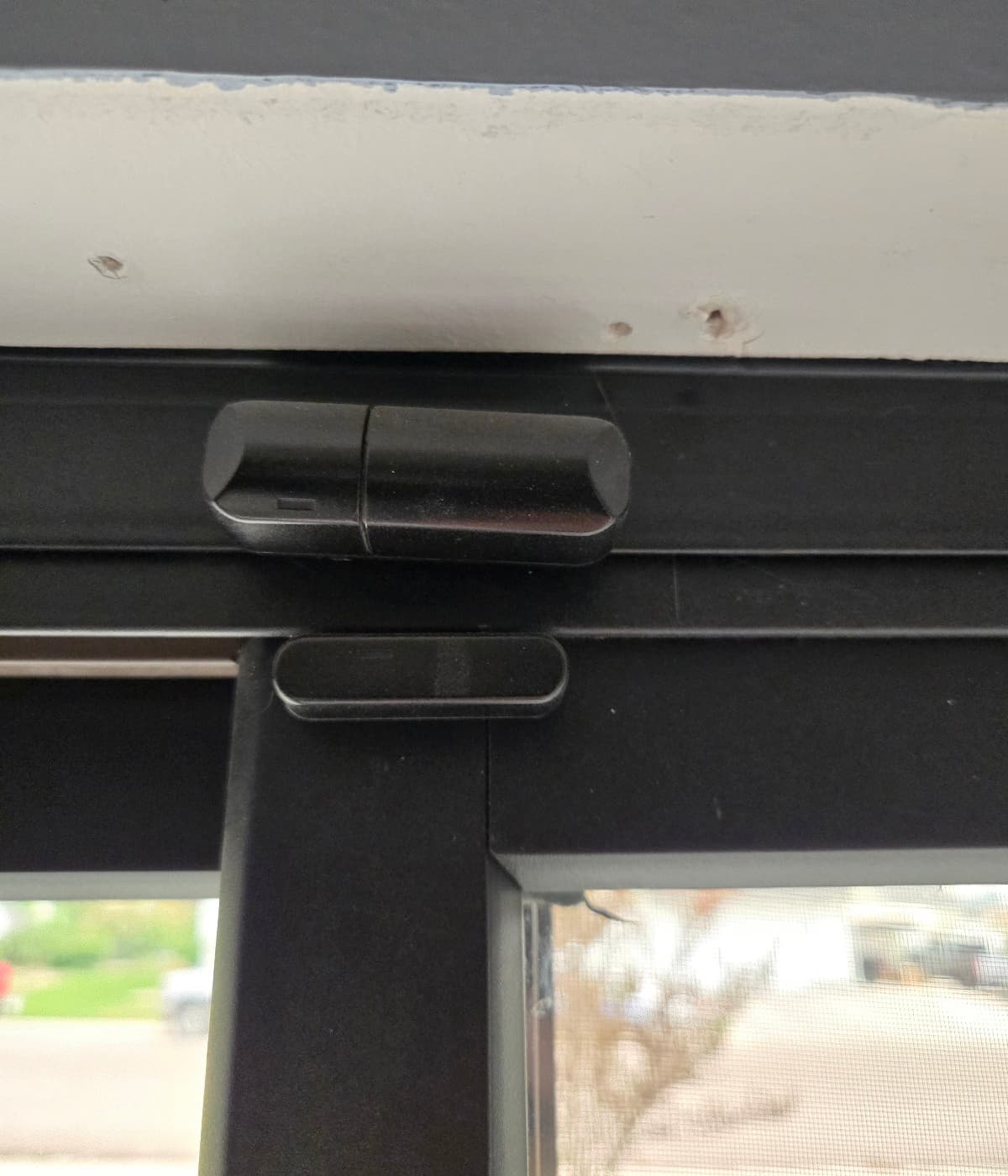

I have Iris V2 that i had painted black a few years ago, just using a spray can and they turned out great.
Just do a light spray, wait 15mins and do another layer, and repeating unti its covered. I think it was 4 sprays i did. And then let it sit for a few days before touching to let it dry completely (or you might get fingerprints)
