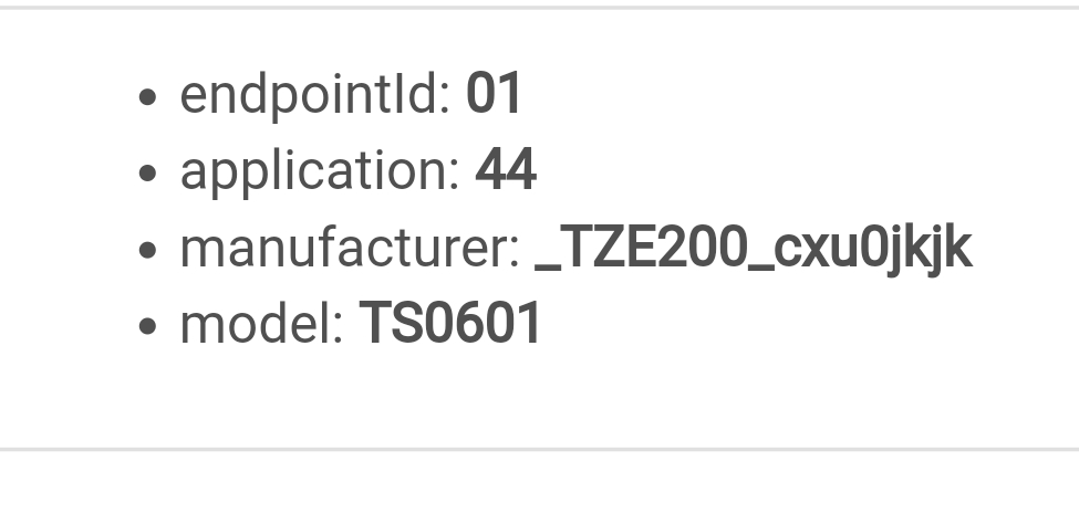

Just received the the device and here is the following information. Does the Zemismart roller shade supports it?
Sorry @yanivsh23 , please re-post the above information as a text, not as a picture. I spent 5 minutes trying to enter xucysydshjsdhjhsd, trying to OCR it - nothing was found.
Sorry for that @kkossev , i didn't know.
Here the information
  • endpointId: 01
  • application: 44
  • manufacturer: _TZE200_cxu0jkjk
  • model: TS0601
I have added _TZE200_cxu0jkjk fingerprint to the latest dev.branch version 3.3.4.
https://raw.githubusercontent.com/HubitatCommunity/zemismart-zigbee-blind/refs/heads/main/Zemismart%20Zigbee%20Blind.groovy
Please give it a try and let me know if it works.
