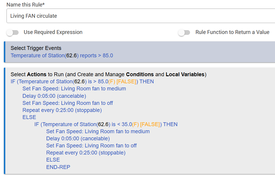

Will this work the way i think it should?
Hello
Trying to take what I have learned from my other questions and apply it here.
I want the fan to cycle - this room has vaulted ceiling and mixing the air makes the temp much more balanced

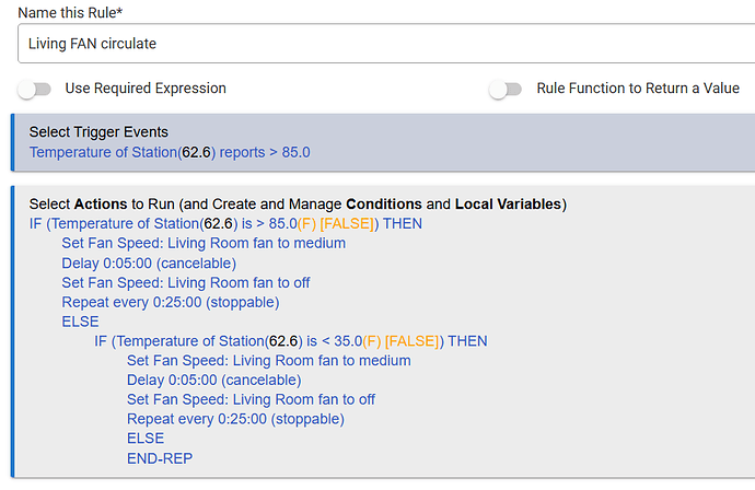

I'm sorry to say this, but there is a lot wrong here... I don't use repeats myself, so I'll leave it to someone familiar with that stuff to help there. But I see no mechanism to stop this rule's (repeating) actions once it starts, so that will need to get addressed.
You're missing End-Ifs to properly close any of your If statements.
Your stuff about <35 is never going to happen since you don't have a trigger event that would call it.
As it stands now, this rule will trigger every time Station reports a temp >85... Depending on how "Station" is programmed to report temp, that could be really often. That will almost certainly be problematic.
I'm guessing other users have tackled this same sort of desired action before (periodic circulation), so hopefully someone will be able to provide an example that's working for them.

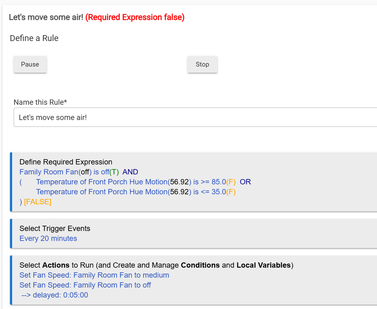

I recommend thinking about this one from a different perspective. Take a look at the following rule, which is much simpler to me. :wink:
Hope this helps!
This rule uses a "Periodic Schedule" trigger, using the Every 30 Minutes feature. It also has a Required Expression that will prevent the Actions from being run every 30 minutes unless the temperature is greater than 85 degrees. The actions are pretty simple: 1) turn on the fan 2) turn off the fan after a 5 minute delay.
The End-rep doesn't stop it ?
half the time im told to use them and half the time I'm told it doesn't matter. so i never use them to keep from getting confused

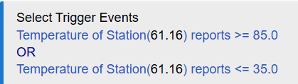

yeah i notice i adjust the trigger i made conditions forgot to put it up there.
I didn't think about that, but currently it only polls my weather station API every 15 minutes - no clue how to prevent that
why im posting here - I feel like the dev of this product just assume everyone can program or has knowledge of it.
The only time you can get really away with not using an End-If is when a singular If statement is involved. Otherwise, missing End-Ifs will generally be problematic.
Instead of erring toward never including End-Ifs, I'd encourage you to always include them -- then you're always covered.

okay where in world do the end-if go ? i i put it before the "else" doesn't the stop the code?
the problem is the way my brain think things flow and the rest of world mine is always complete different lol.
Every If should close out with an End-If -- if there are 4 Ifs, there should be 4 corresponding End-Ifs.
When multiple If statements are used, the End-Ifs ensure that the rule properly progresses to the next component.
like this ?

I was remiss in an earlier post where I implied that an Else-If also needs an End-If. Since an Else-If is a component within an If, then just that original If needs an End-If to close it out.
In the Documentation, there's a good example of a IF - Else-If - Else - End-If. The link below will automatically scroll down to the section with that example.
What I am seeing in your rule is that you want the fan to run at medium if the temperature is either grater than 85 or lower than 35. The rule as written will not work, so I would recommend you disable it for now and start a new one.
I would do the following (essentially what @ogiewon suggested):
Required Expression:
Temperature of Station is > 85.0 or Temperature of Station is < 35.0
To do this, activate the “Use Required Expression” toggle, then “Define Required Expression”, then from the “Define Expression Element”, Select “New Condition”. From there, select: “Temperature”, then chose your Temperature Station, then comparison “<“, then enter 35 in the Temperature field. Once that is done, chose “or” and repeat the selection and setup for Temperature.
Trigger:
Every 20 Minutes
To do this, select: Periodic Schedule, then Minutes as the “Select periodic frequency”, then select “> Every n minutes”, the select “20” in the “> Select number of minutes drop down”. (25 minutes is not an available option for a reason that I won’t go into here…
Action:
Set Fan Speed: Living Room fan to medium
Set Fan Speed: Living Room fan to off —> delayed: 0:05:00
That rule seems simpler (it is), but it will work.
thinking about what you said before - everytime the temp updates - would trigger the rule anyway right ? so for this case the rep rule is redundant and burning CPU cycles ... .

If you click “run now”, it will turn on the fan to medium, then turn it off after 5 minutes. (If you click “run now” multiple times, it will seem like it is doing odd things (stopping), because every time that button is pressed, it adds an action on the hub for 5 minutes in the future to stop the fan. And those actions will remain on the hub until they are executed. This won’t be an issue during the automation, because the rule is only set to run every 20 or 30 minutes.)
If you want to test it, you can create a virtual temperature sensor and use that instead of your Station in the rule. With a virtual device, you can go to the device screen for the virtual station, and manually change the temperature to whatever you’d like.
The “Required Expression” is what will stop it from doing anything unless the temperature is in one of the ranges specified.
The “Trigger” is what will have Rule Machine (RM) run the rule when the “Required Expression” is met (the temperature is in one of the ranges specified).
The Action will only happen when the rule is triggered automatically every 20 minutes (in my example), but only if the “required expression” is met (the temperature is in one of the ranges specified).
Does this help?
If you try writing the rule, once done, take a screenshot and share it so we can confirm that it looks correct.

Yes, this trigger will run every 20 minutes. It will then check the Required Expression and will stop all processing if the condition is not met.
This is a very efficient way of handling this rule, IMHO.

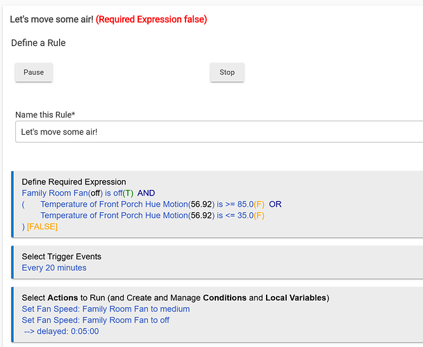

However, there is a downside to the way this rule is configured. If someone has already turned the fan on manually, and wants the fan to run for more than 5 minutes, this rule will stop the fan after five minutes. You can add another condition to the Required Expression (RE) to handle this scenario, if desired. Simply make the RE something like...
Living Room fan = Off AND (Temperature of Station is >= 85 OR Temperature of Station is <= 35)
This way, if the fan is already running, the rule simply will not execute, even though one of the two temperature thresholds may be met.
Here is a modified version that will handle the case where someone has previously turned on the fan, and would like for it to not get automatically turned off by this rule.
That’s a great catch! @v6turbo, I agree with @ogiewon that the rule as he describes should do exactly what you are looking for.
