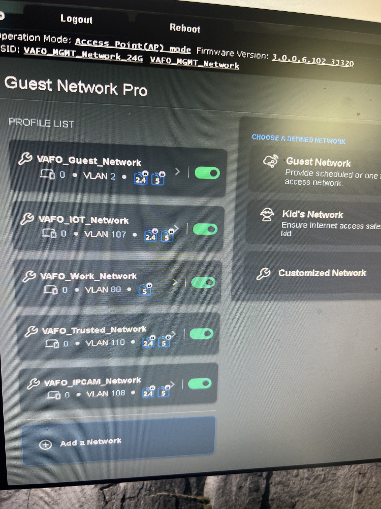

If you want to give ASUS a shot I use this. I use a CWWK minipc as my router / firewall so mine is running in AP mode but it can run as both. Supports hub mesh however the link / tunnel between each mesh does NOT support vlans. So only the primary router would support vlans and the meshed devices would only get your management vlan or the first vlan setup I believe.

2nd asus, I have been really impressed with mine. The software is great with loads of extras like built in VPN etc. It's all included in the price which is why it's costs a bit more but the ability to separate IOT etc is built in.
I brought it for the firmware thinking I would need another in mesh mode however it's surpassed my expectations and reaches everywhere in my house. No router I have had has ever done that.

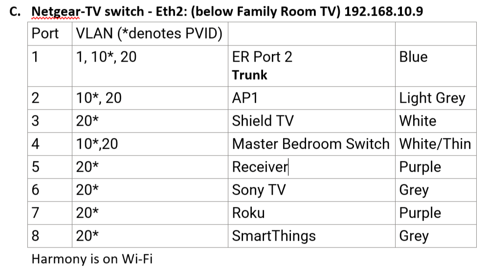

VLANs are defined on my router (Ubiquiti EdgeRouter12) and each managed switch is configured to expose desired VLAN(s) on each of its ports. So you tell your switch(es) which VLAN(s) to expose on each port, and plug the devices into the switch ports w/the desired VLAN(s) available. For example...the switch in my entertainment center configured to allow access to VLANs 10 (personal) and 20 (IoT):

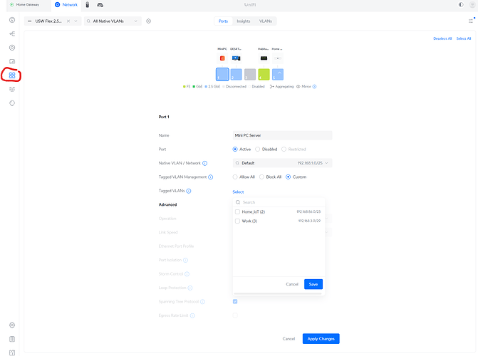

When you get Unifi part of what you are paying for is the Unified network experience via their controller software. Their controller which is built into the UCG-Ultra. Once you adopt a device like a switch you can configure it the way you want it. Here you can see my Flex mini Switch and the configuration of one of the ports on it. Here you can see I set the Native VLAN/Network to my default, Then the option below it is to managed the Tagged Vlan's, I have select Custom to show how I can pick and choose what vlans are assigned to the port.
