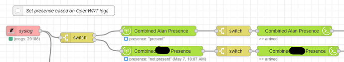

I added the 'node-red-contrib-syslog-input2' node to Node Red and set it up to listen on UDP port 20514. In OpenWRT, under System -> System -> Logging I set the external system log server to my Node Red IP, port 20514, UDP. I set the system log level to Info to reduce the message traffic - the default was Debug.
In Node Red I created a flow that starts with the Syslog node and then goes to a switch with two outputs. Output 1 is if the msg.payload.msg matches regex "DHCPACK.*xx:xx:xx:xx:xx:xx*" (set to my phone's MAC address). Output 2 is set up for if the msg.payload.msg matches my wife's MAC address.
If a log message matches, the next nodes are a Hubitat Device node and a switch node to check if the combined presence device's presence attribute is != present. If it isn't, the message passes to a Hubitat Command node that sets the combined sensor to 'present'.
The surprising thing is that I've already seen this flow activate several times in the first 24 hours it's been set up. I thought this would be a backup to the backup to the backup for presence sensing, but it may end up being the first sensor to detect arrivals a good fraction of the time.
