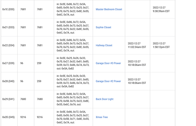

Overall this sounds like a weak mesh issue.
I understand.
It's 15ft away from the hub, you'd think it would consistently work

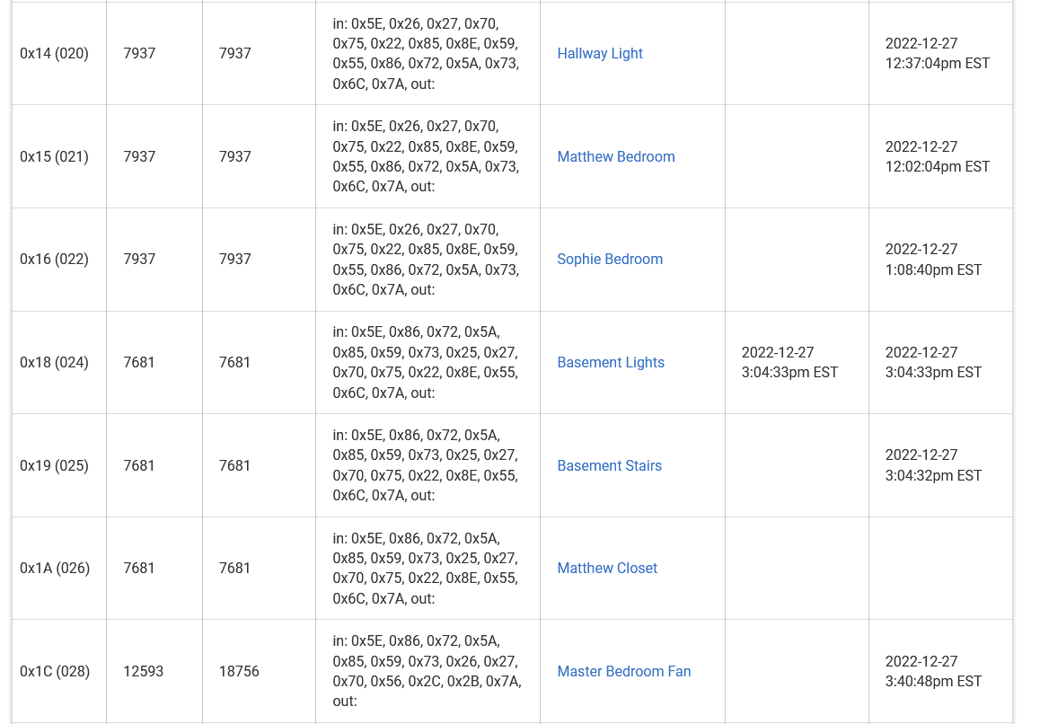

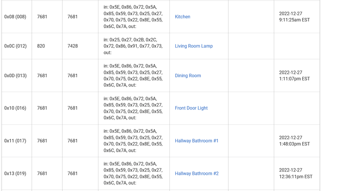

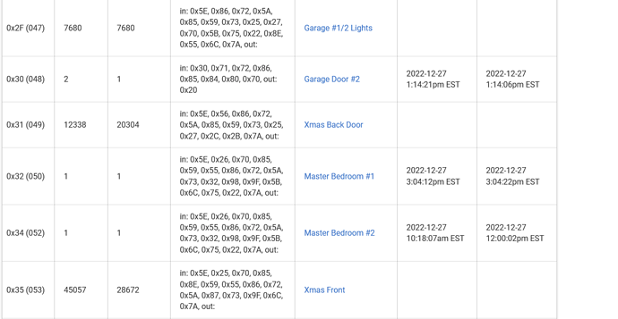

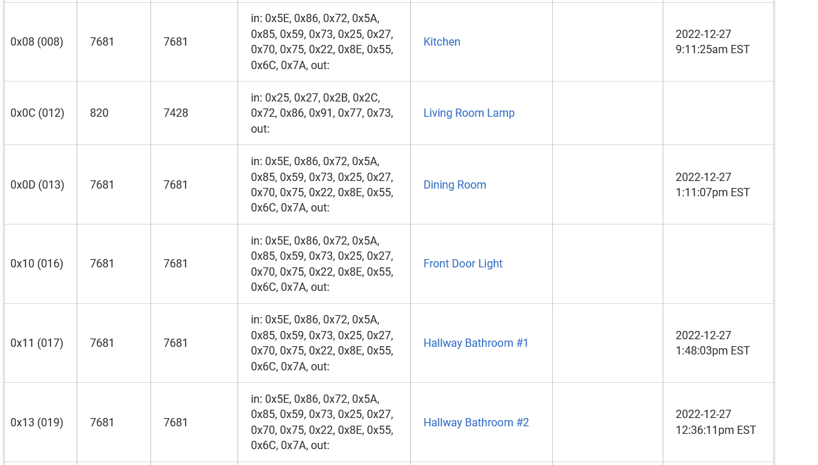

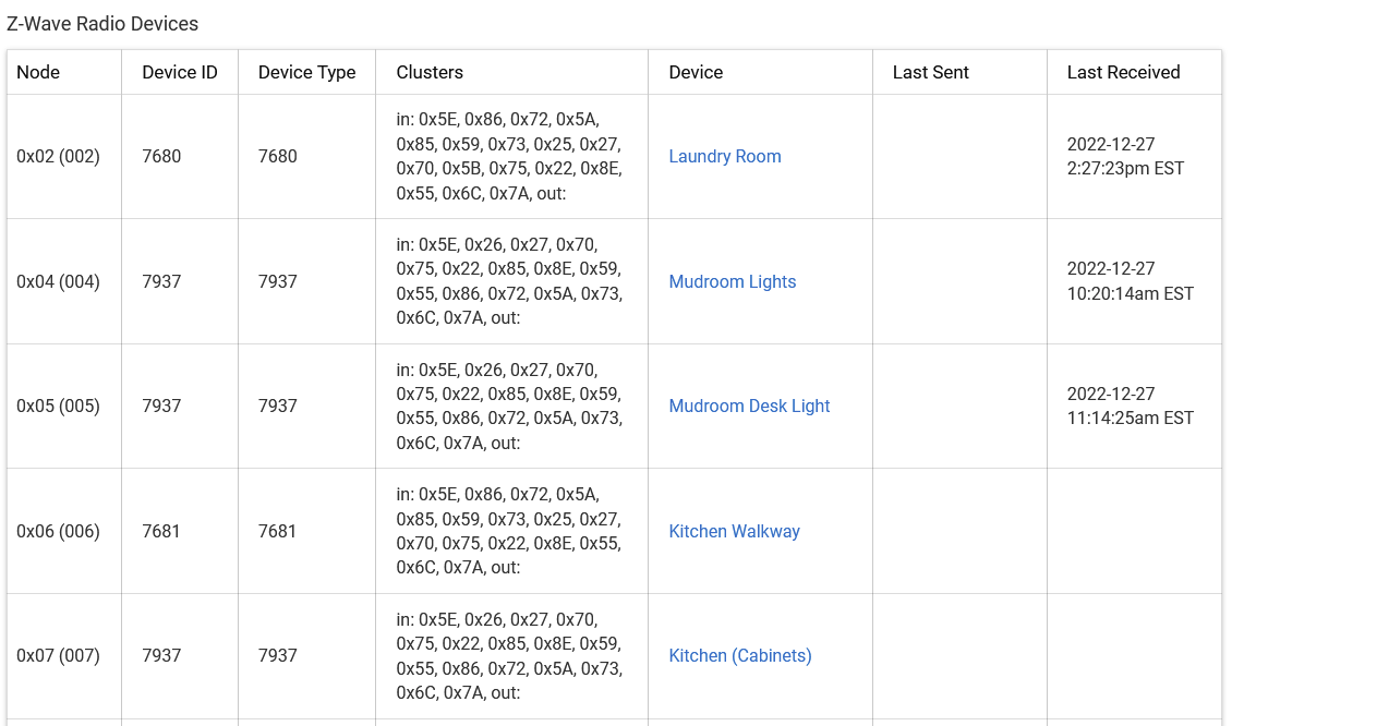

Not always.... Throw a repeater in the mix and see how it behaves. Can you post a copy of your z-wave details page in it's entirety?
Here you go
Ahh thought you had a C7... Was looking for ghosts. But you need the Silabs software and a stick to check for ghosts on the C5...
I bought a couple C7s but didn't set them up yet.
