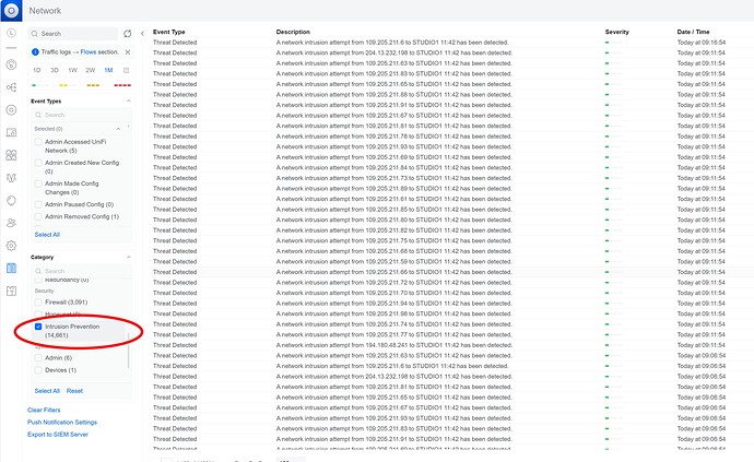

14,660-something attempts to gain access to the PC in my studio from some entity in Azerbaijan via using an old forwarded port I left open for Remote Desktop. With that many attempts, its a really good thing I have a strong password. Plugged that security hole just now!
Glad you don't have an alarm set for intrusions like me, that would blow up my phone, for sure LOL
Another reason to setup VPN and the firewall...
This was the old hole I left open as an alternate incase something happened to the VPN server. Ironically, the port forwarding rule for this was named "unsecure-bad idea"

I used to see similar when I'd port forwarded for remote CCTV access. If the standard http and server ports were kept, the logs were full of 'illegal login' attempts, literally thousands over an hour or two. Using non standard ports helped but I wouldn't use port forwarding any more.
I thought I would be safe using a non-standard port. Rather than exposing the RDP port (3389) to the outside world, I used a random port (17273). Apparently that doesn't help though...
I install CCTV and up until about 8 years ago, Hikvision were recommending port forwarding as their own service was so woeful. It's all cloud p2p now and the service works very well. We are almost forced to use that cloud connection as all of the best features in the apps are unavailable without it, making VPN a non starter.
Unfortunately, it does not. I've been in IT professionally for over 30 years. Port forwarding, unless needed for a very specific use case, has gone the way of the Dodo Bird.

ya vpn server is now the way to go allow rdp access. even that has issues as people try to hack the vpn ports.. sigh
