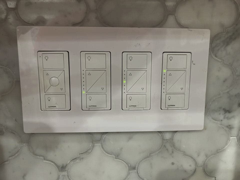

@Kaitlyn Clear connect (What caseta uses) is a spoke and hub protocol and not a mesh protocol. The remotes have a good range, they can also mount in an existing box or on the wall with a switch cover and they are indistinguishable from a real switch. (This is nice in multigang situations too) (The far left is a pico, the rest are dimmers) You can also put them on pedestals

@Kaitlyn a pico remote fits inside any decora wall plate. It works if there is a gang box behind it and also works if there is no gang box behind it. And also works in combination of the above. (In the picture above with a pico on the left side of a 4 spot decora wall plate, is there a three gang or four gang electrical wall box behind the decora plate? We don't know and would have to ask @rlithgow1
This illustrates how versatile the pico is and how you can place it in either a single gang, multiple gang, or no gang location.
This feature allows for an installation look and feel that is orders of magnitude beyond most other options, including the link in your post. Combine this with rock solid reliability and an inexpensive price and there is simply nothing else that comes close.
Yes, but a box isn't required if you just want to mount it with a plate. The mount has adhesive in back of it,

@Stephan.J to add to this statement, I have a few 2 gang boxes with 3 gang plates on them where the Pico mount is screwed into the drywall beside the 2 gang box. Like I said in my post above the wall mounts a very flexible whether you want to just stick them via the supplied double sided tape or screw them into the drywall.
