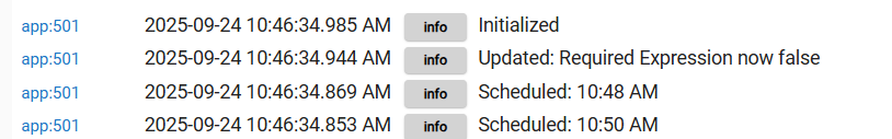

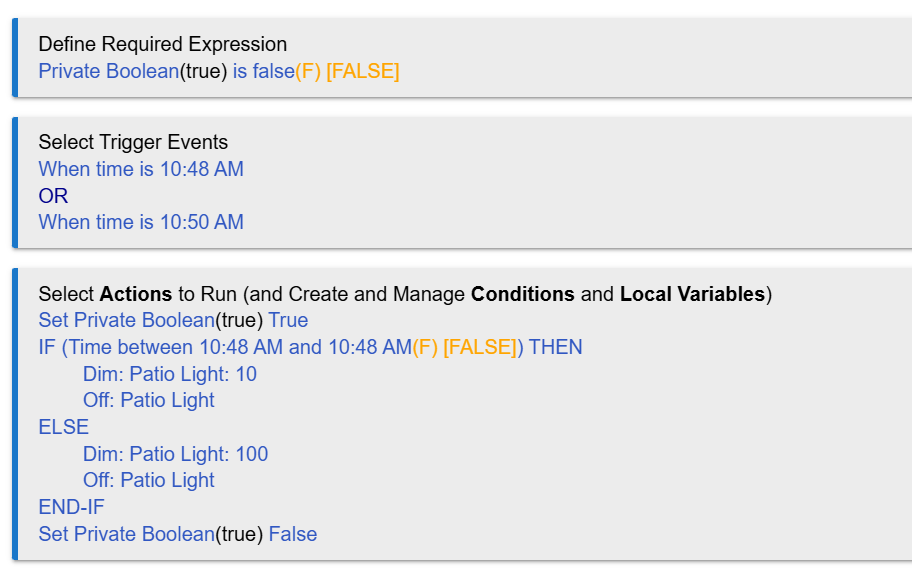

I completed writing this rule at 10:46 AM. When 10:48 AM occurred the bulb never dimmed to 10. You can see in the log it doesn't look like the script did anything after 10:46 AM. I did refresh the logs several times. I'm simply trying to dim a bulb to 10 at one time, then dim it back to 100 at a later time. There must be a better approach.
"Time is..." triggers aren't susceptible to timing or repetition issues, so using a PB isn't necessary with them.
Using the very same time at both ends of a "Time is between" conditional isn't good logic.
You're sending an Off command immediately after each Dim command - what are your intentions with that?

Adding to the above, which would be a better way to do this, the logs are clear about why this happened: your required expression is false (both in the logs and in your screenshot). Your trigger will never fire the rule when that is the case, as spelled out in the documentation, which I'd again encourage you to read, and many previous discussions, which I'd encourage you to review to help retain.

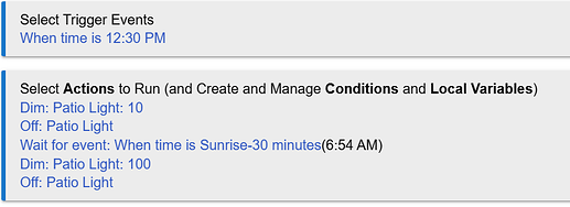

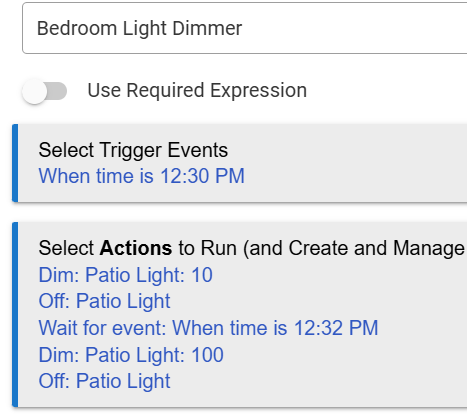

Here is what I wound up with after discovering the "wait for event" command. Once I receive my dimmable bulb for my bedroom I plan on setting it to 10 shortly after bedtime. Then when getting up in the middle of the night the light is less harsh. Then restoring to 100 in the morning.
Thanks again.
You still have this problem with your new rule, so I'd look at this question again:
Unless you're maybe just looking for a brief flash of light, you might as well just use the off and get to the same result faster. :slight_smile: But I suspect that's not what you're wanting. What is?
Because if I do a Dim: Patio Light: 10 the light remains on. I didn't see any other way to handle it so I just turn it off after each Dim command.

That rule in your screenshot is dimming a bulb to 10%, then turning it off.
Then some amount of time later, it’s turning it back on at 100%, and immediately turning it off again.
Right, but that's not what you're doing. You are dimming it to 10 and then immediately turning it off. Assuming the off is intentional, there was no mention of this desire in your description (or any reason as to why you might want to, a question that still remains).
That's only because dimming it turns it on and I want it off after dimming. Unless there's a way I'm unaware of to keep it off when dimming?
No, that's probably the way, but the "why" would still be interesting to know. It's possible another approach would work better if turning it on later uses an automation, assuming my guess (which is just that without more information) is correct. Again, the reason so many people asked is because this information was neither shared originally nor after many attempts at clarification.
