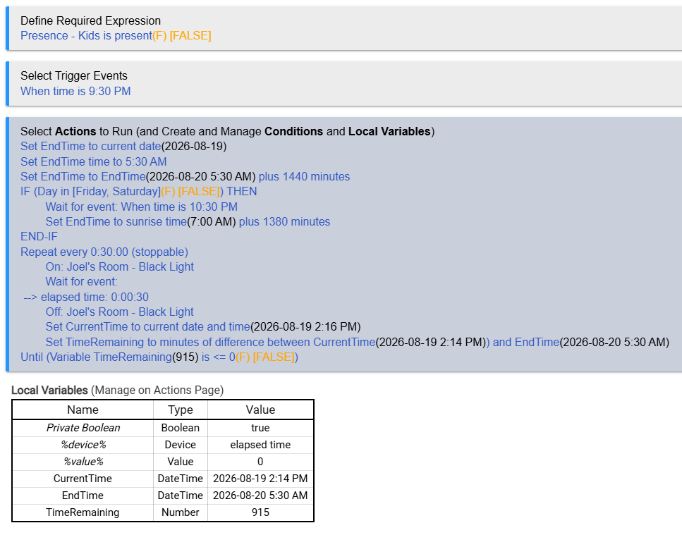

  1. I already have a virtual presence sensor for if the kids are here. It is just synced to one of my Google calendars that my ex and I use for scheduling who has them when. I set up a virtual switch already for school days. I subscribe to the school's calendar through Google too.
    • Required expression already done.
    • Trigger already done. I finally figured out that there are more triggers than there are conditionals, and I can use "Day of the week schedule" as the trigger.
    • Several issues with these actions.

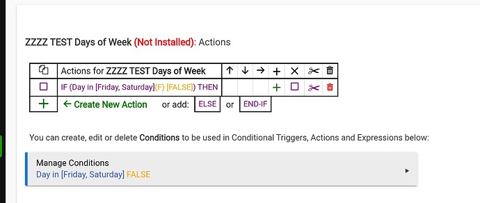

      • There is no way to do IF (day == Friday). In the actions, there is no way to check what day of the week it is as far as I can tell.
      • Action 5's stop expression.... RM does not allow you to OR the while statement. But I think you can do IF(Kid presence departed) {STOP REP} before the while conditional if you need more than one way to stop it.
I don't really need help with the logic. And I can think of workarounds. Who cares what day of the week it is for this rule? All that matters really is if he has school tomorrow, because he wakes up earlier and I don't want the black light coming on unexpectedly when he's climbing out of bed or something. I have a way to determine if it's a school night.
It doesn't really change my points about there being no way to check the day of a week in an IF statement in the actions, there should be a condition for before/after a certain time (even if just for the repeat until action. I just wanted to enter an end time for the repeating to stop), and the inconsistencies in selectable times between the various built-in apps.

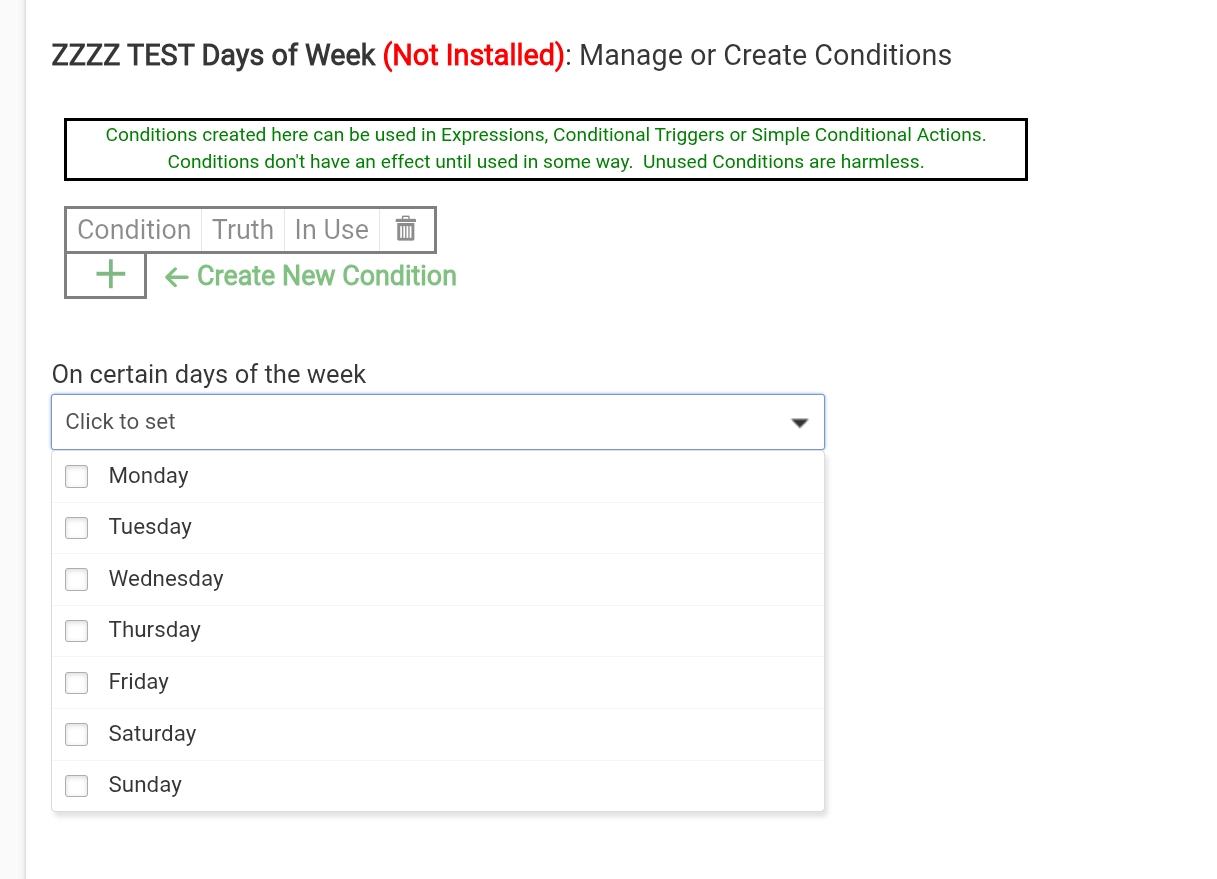

There absolutely is
Days of week conditional

They are, but I believe their screenshot is from the conditions management page, which is accessible via the actions page. It's unfortunate that setting up conditions this way offers a different set of options than the conditional action creation/new condition path, but that's the way it is at the moment (and it has been flagged before).
It is after today but before tomorrow, and not specifying the day, or assuming it is implicitly today, leads to confusion.
I thought the suggestion was to restrict the loop to between two times, not to make it stop "between two times".
Like so:
No, it was from setting up the conditional action -> Using "New Condition" since I did not have any conditions in a blank rule. But, the screenshot was from a first action of "conditional action" -> If condition then

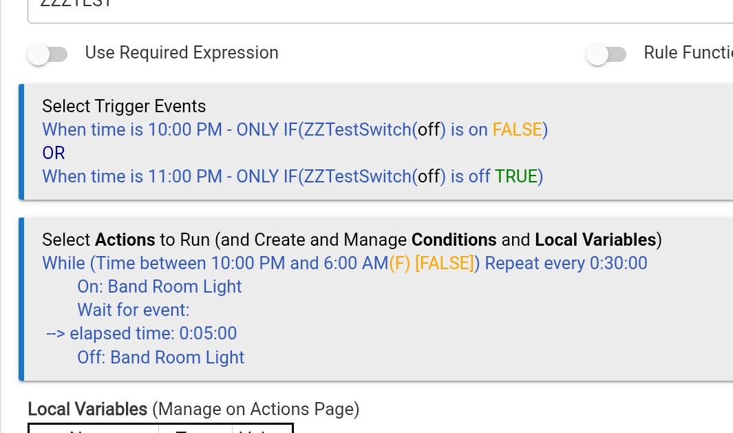

Repeat While condition? (PS - If you use the second photo, don't forget the final EndRep at the end)
I can do that... but I still need to specify a start time. The goal is to, as some point, move it away from starting at a preset time and wrapping it up into a more general "Kids Bedtime" scene. At my new house, I don't have much setup yet so this is literally the first part being added. The scene being triggered is what will trigger this rule (probably with a 1 hour or so delay) and start the loop, eventually. I just want it to repeat when triggered and have a set end time for the repeating. So I do want a do-while loop and not just a while loop.
OMG! I never knew this had different options. Why on Earth would that be the case? Knowing that, adding the condition there and then adding it to the rule is a piece of cake. I need to poke around in there and see what else might be missing when adding it from the new action screen. So now it just triggers at 9:30 and just waits an hour to start repeating if it's not a school night. Still need to finish setting that up, but that can come next.
Well, I got the rule setup how I want it. I still believe there should have been a much simpler way to accomplish this.

So I am reading the logic,
You set the date to today
Set the time to 5:30 AM
Then set the time to 24 hours later than the previously set time
If it is a weekend, you set the time again to an additional 23 hours longer. I am thinking you are losing something here. It looks like you already had it set for tomorrow at 5:30 AM and then change it to sunrise. I think that is date agnostic, and just sets it for 7 AM tomorrow since that was the date it already was, then adds another 23 hours. Then wait for 10:30
When that is done, it will start the loop of
Light on
wait 30 seconds
light off
Check current time
Evaluate the difference
Loop end when the difference is 0
YOu could get the same with a similar set up to what I showed
Required Condition = Kids Present
Trigger 1: 9:30 PM
Trigger 2: 10:30 PM
Actions:
conditional if school day(night) is true
Do while time between 9:30 and 5:30 AM, repeating every 30
On Light
wait 30 seconds
Off Light
End Rep
Else if , conditional if school day(night) is false
Do while time between 10:30 and Sunrise - 60, repeating every 30
On Light
wait 30 seconds
Off Light
End Rep
When you do set time it only changes the time, not the date. It's a little confusing because I ran the actions to test it, so the screenshot is showing the current value of the variable. So it shows 5:30am tomorrow there because I had already run the action and it was set correctly.
Here is the value of EndTime after running the first action:
Second action:
Third action:
I have to do it as separate actions because if you choose set date and time, you have to enter a specific date. There is no built in "tomorrow". Also, none of the set actions allow you to specify an offset. So you have to get the current date, then set the time you want on some other date, and then offset it by however many days you want.
Another issue is that sunrise time doesn't recalculate until after midnight. I want it to stop an hour before sunrise so I set the endtime to the current sunrise time for today and add 23 hours to it. It'll be off by a couple of minutes technically but it doesn't matter.
Here is the value of EndTime after running the action that sets it to sunrise + 1380 minutes:
So your do while loop wouldn't work because when it starts, sunrise - 60 happened over half a day ago. I also don't have to duplicate the loop this way either.
