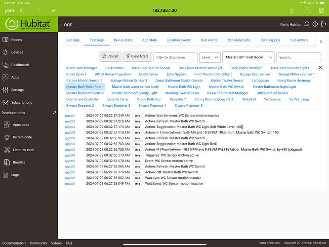

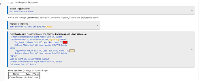

I am stumped by this - I added a new rule that is supposed to turn on a light in our bathroom when my new presence sensor is active and turn it off when inactive but between certain times I want the light to be red (at night so it doesn’t wake me up). I am using a Zooz Zen 74 and a Orien RGBTW Smart Bulb that is being controlled by the Zooz. I have my system integrated with HomeKit. The rule seems to work perfectly exceept the one line that is skipped (see logs). I have also attached the rule configuration. Any ideas why this is happening?
My Hub model is C7 and my Platform version is 2.3.9.157

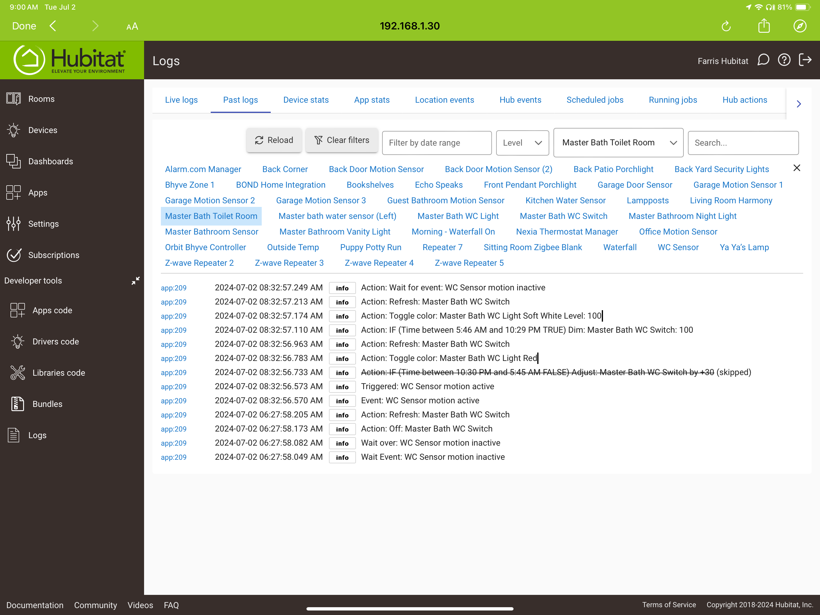

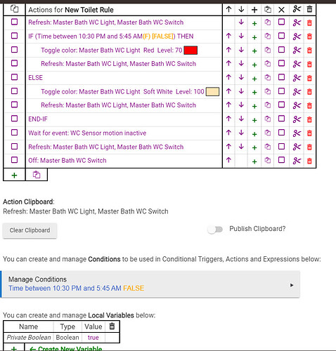

You have two time ranges, and only one will be true.. the "false" one is skipped. If it's false, there's nothing to do and skipping is the expected result.
At a minimum, you need an "End If" after the first "Refresh" line to complete that first "If", and depending on your intentions, you should use another one somewhere to complete that second If.
You could likely just use an ELSE instead of that second IF, but 2 complete IF statements should at least get it working.

I'm at the office now, so can't provide a screenshot, but if you click on the Actions block, it will take you in to the editor.
There should be an option at the bottom of that table to add an End If, and you can then just move that up to the correct spot.
It looks like an End If is needed after each of the first 2 Refreshes.
Since the 2 timeframes look like they cover 24 hours, you could consider just using one of those conditions for an IF statement (and dumping the other), and then use a plain ELSE instead of the second IF, but using 2 complete IF statements should work fine too (what you have now plus the 2 End-Ifs).
ETA -- if you have just one IF stmt in a rule, you can often/sometimes get away with not using an End-If, but it's good practice/technique to always use an End-If to close out any IF stmt -- that way, you don't ever get burned by missing one.
You actually don't need (well, "can't use" really) END-IFs above--these are simple conditionals that apply only to that line. Perhaps that isn't intentional and they were meant to be regular conditionals, in which case you'd need to delete the line and replace it with an "IF (expression) THEN"?
It's hard to say more without knowing what you actually want the rule to do, other than that RM is correctly evaluating this condition and skipping the line based on your logs (and the current time) above--though making a guess based on your actions, I assume you really do what two "blocks" here, an IF THEN and an ELSE (or possibly ELSE-IF), closed out by an END-IF. That structure is more or less the same as VBA except slightly different keywords (and the fact that RM isn't "code" per se--you just select the option from the editor). :slight_smile:

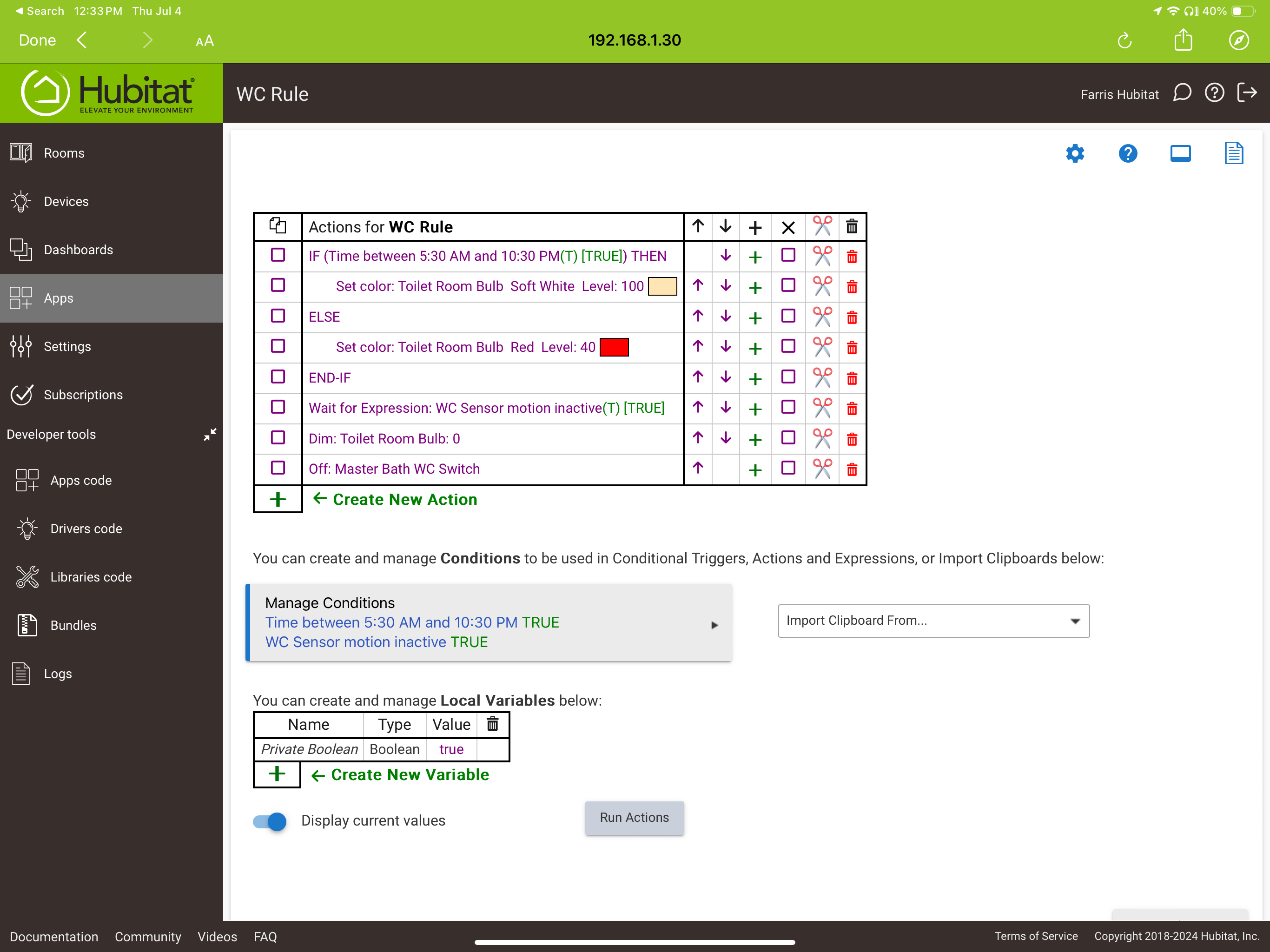

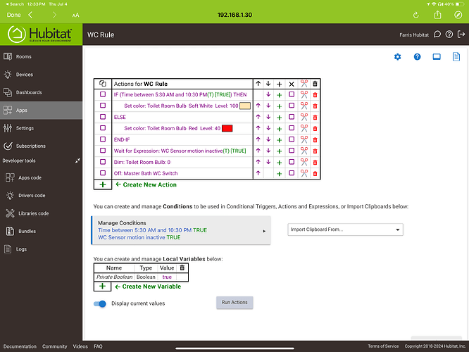

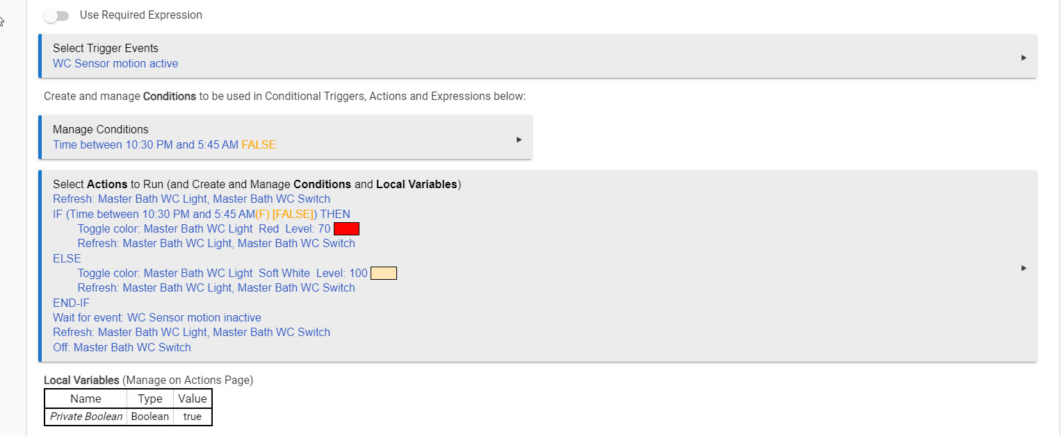

Okay, I think I got it this time,
thanks to you guys. Take a look...
Do you see any issues? I wasn't sure that the refresh(s) might be overkill, but when I was playing around with it, sometimes refresh would clear out an issue, so I stuck them in there.
Let me know what you think.

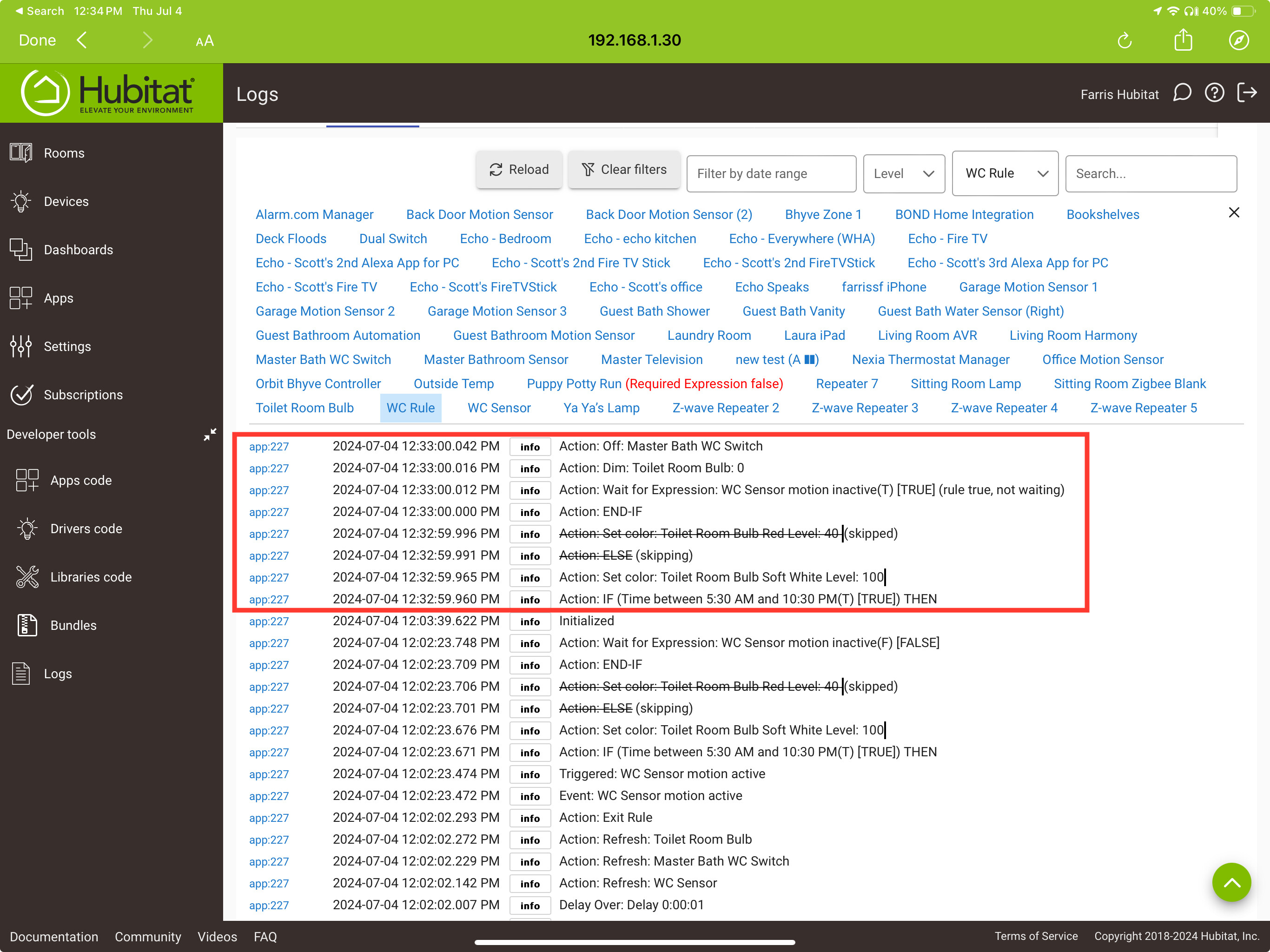

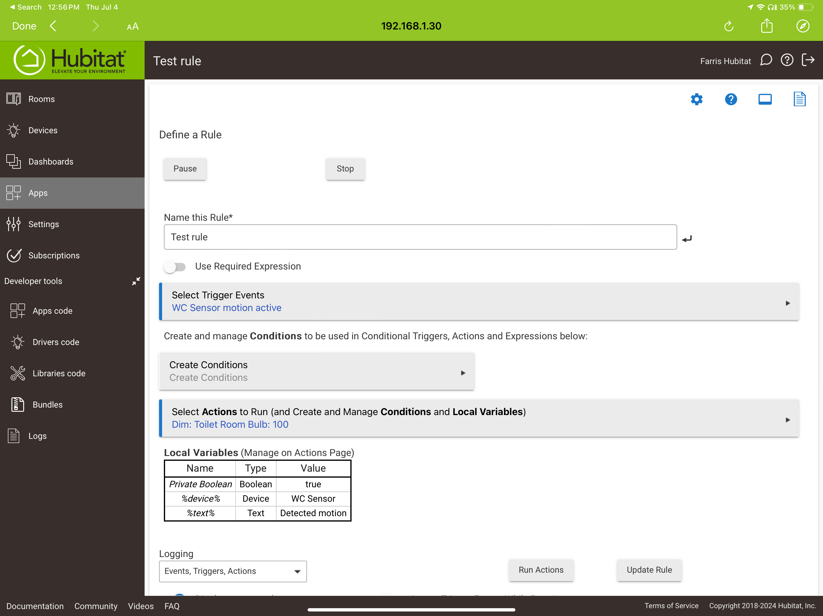

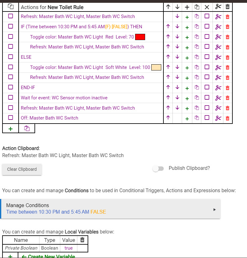

Well that didn’t work! Frustrated… what am I doing wrong?
I'm not familiar with the "Toggle color" option, and I'm wondering if that command is perhaps an issue for some reason... If you try just using the "Set color" option instead of "Toggle color", does that make a difference?

As mentioned above, knowing what is actually happening would be the most helpful piece of information to figure this out. Also helpful would be logs from the rule, like you provided in your original post.
I'd second this advice. The "Toggle color" option will turn the bulb off if it's currently on (as reported on the device detail page, which ideally would match with the device, but this is all the hub "knows") or on to the specified color if it's off. Is that what you want?

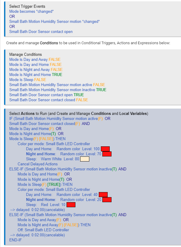

I have a similar rule that works fine, Rule Machine should be able to do what you want.
It's still not clear what's actually wrong. Can you look at "Logs" for the rule to get some clues, or provide them here so someone else can do the same?
Another thing that might help narrow things down: leave the rule out of the picture for a moment. Just try the commands directly on the device detail page, like Set Color. (Click the color box to select a color, click out of it to save, possibly depending on your browser/OS, then click the Set Color button itself to run the command.) If it doesn't work here, a rule won't work either, but you've narrowed the problem down to something with the device or driver.

I think I may have figured out what the issue is. The bulb is a Orien RGBTW (Matter) Smart Bulb. In order to install you have to put it in HomeKit, then go into HomeKit and put the bulb in Pairing mode, copy a number down, go to Hubitat, add the bulb by clicking Mattter button, and enter code, once you do that, then you have to pick the matter RGBTW driver. That last piece is what i missed. Once I changed the driver, it stopped hanging up. It seems that. Was the issue. I am trying to use the room lighting program but it is a nightmare! I am deep into it so i kinda don’t want to give up but if I can’t figure it out, I will go back to the Rule Machine. I will post either way.
I had that in there because it was not responding. I removed it, it did not make a difference.

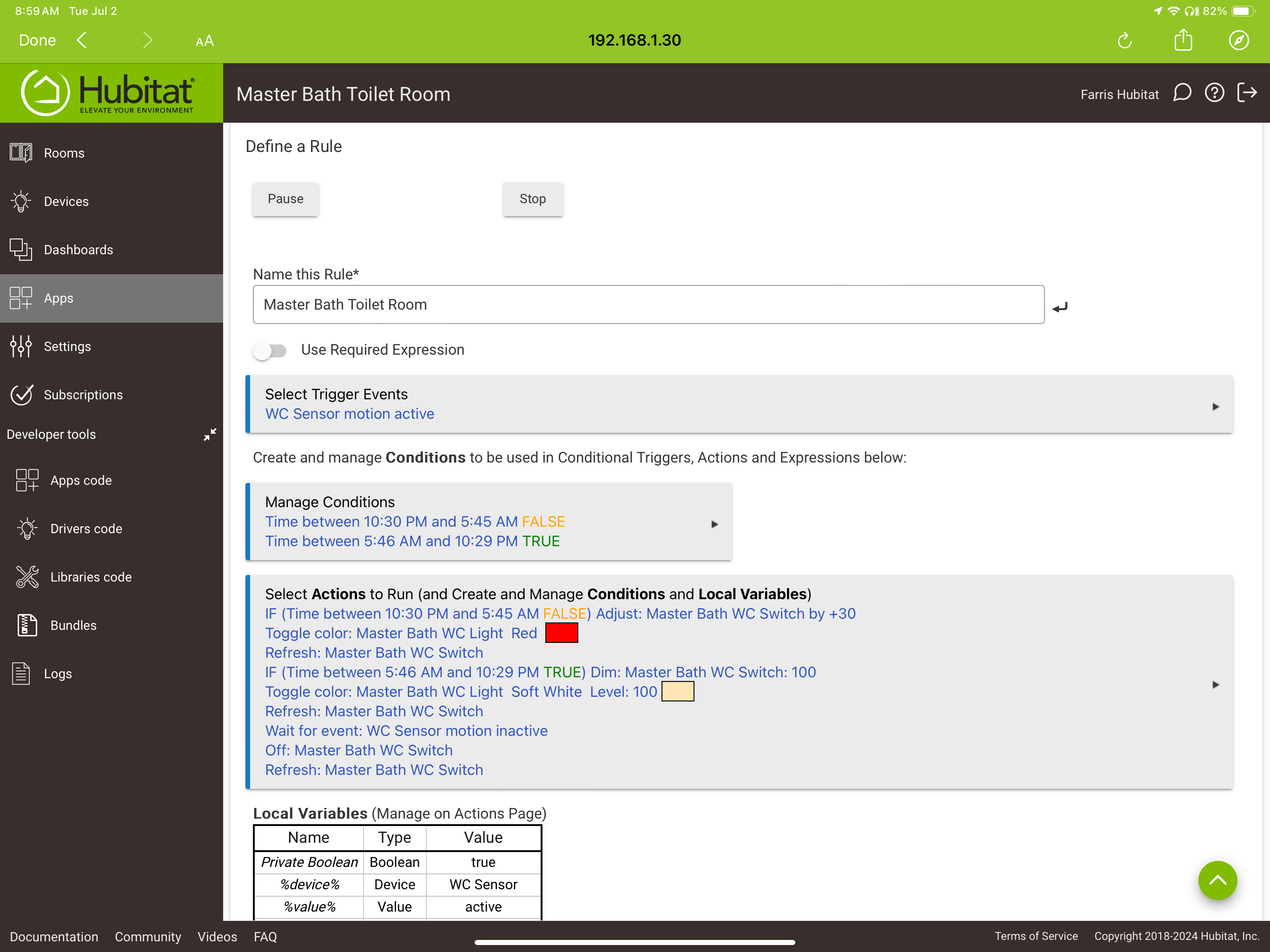

I have tried multiple ways and have not been successful, This is the latest iteration

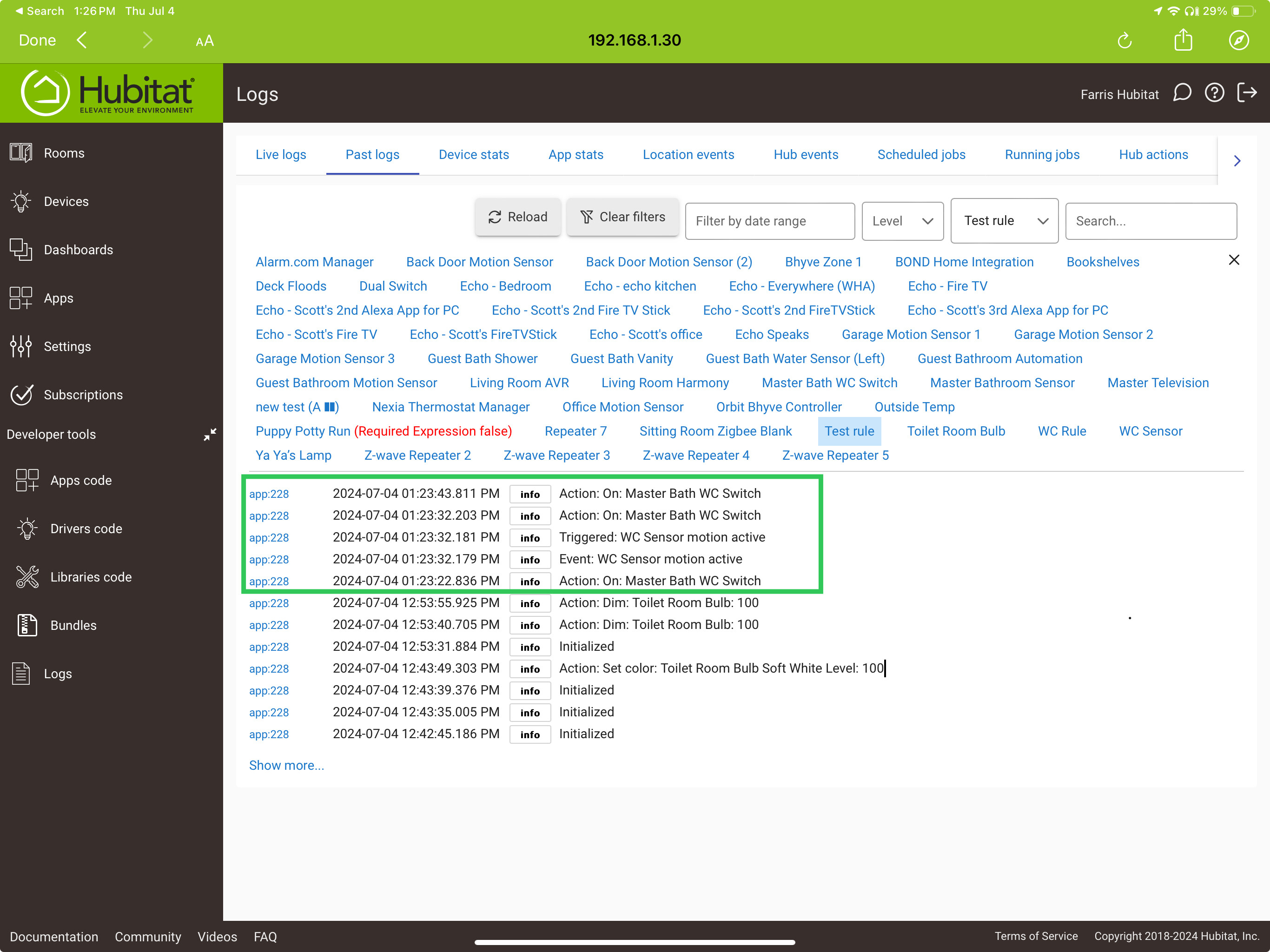

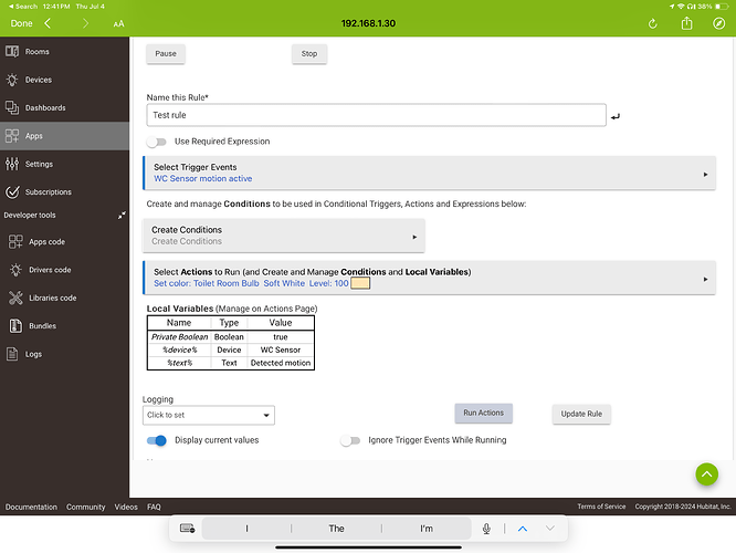

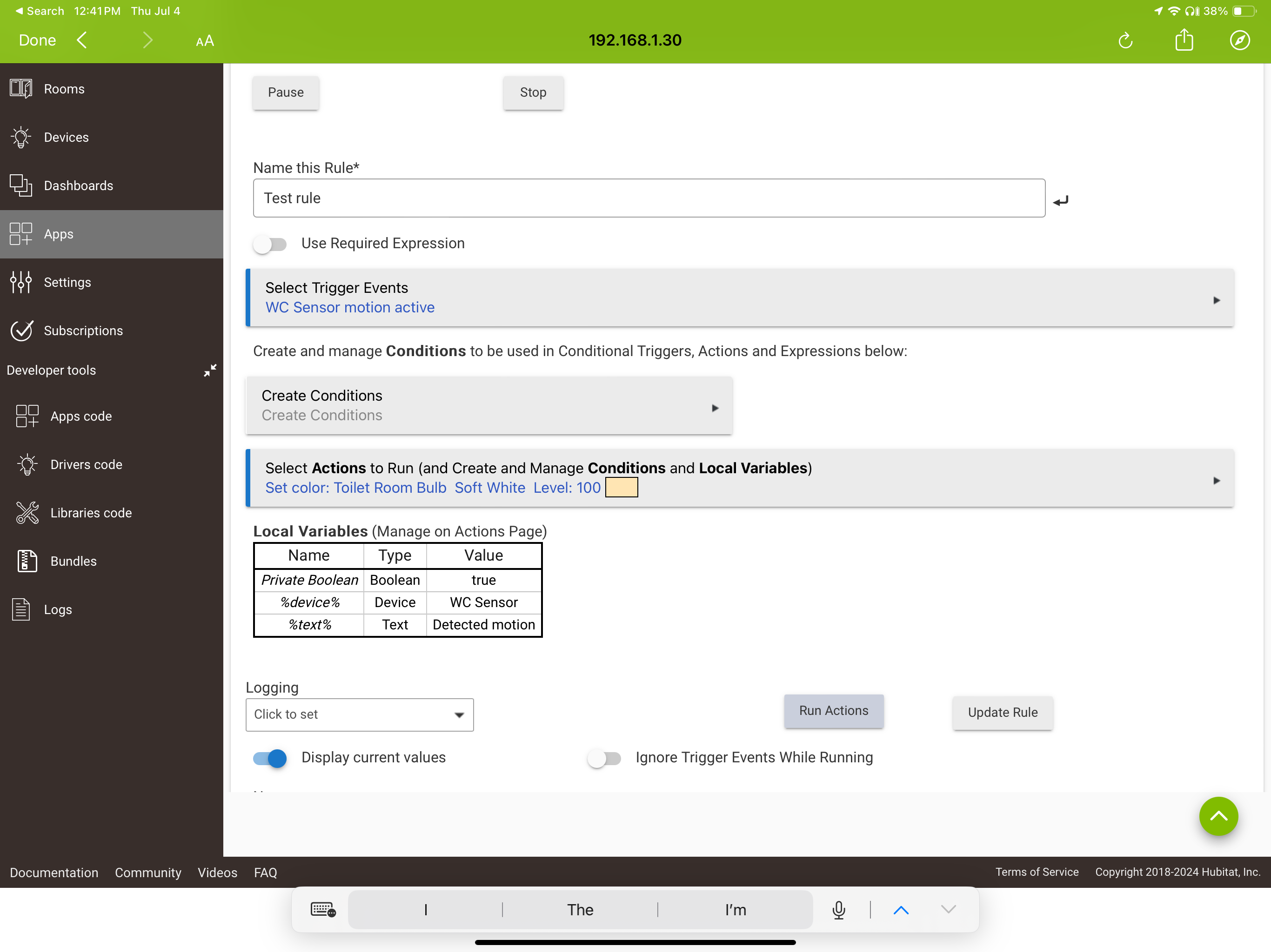

After thinking about it, I decided to break this down to a series of small steps (Test Rules). The first one I tried was this:

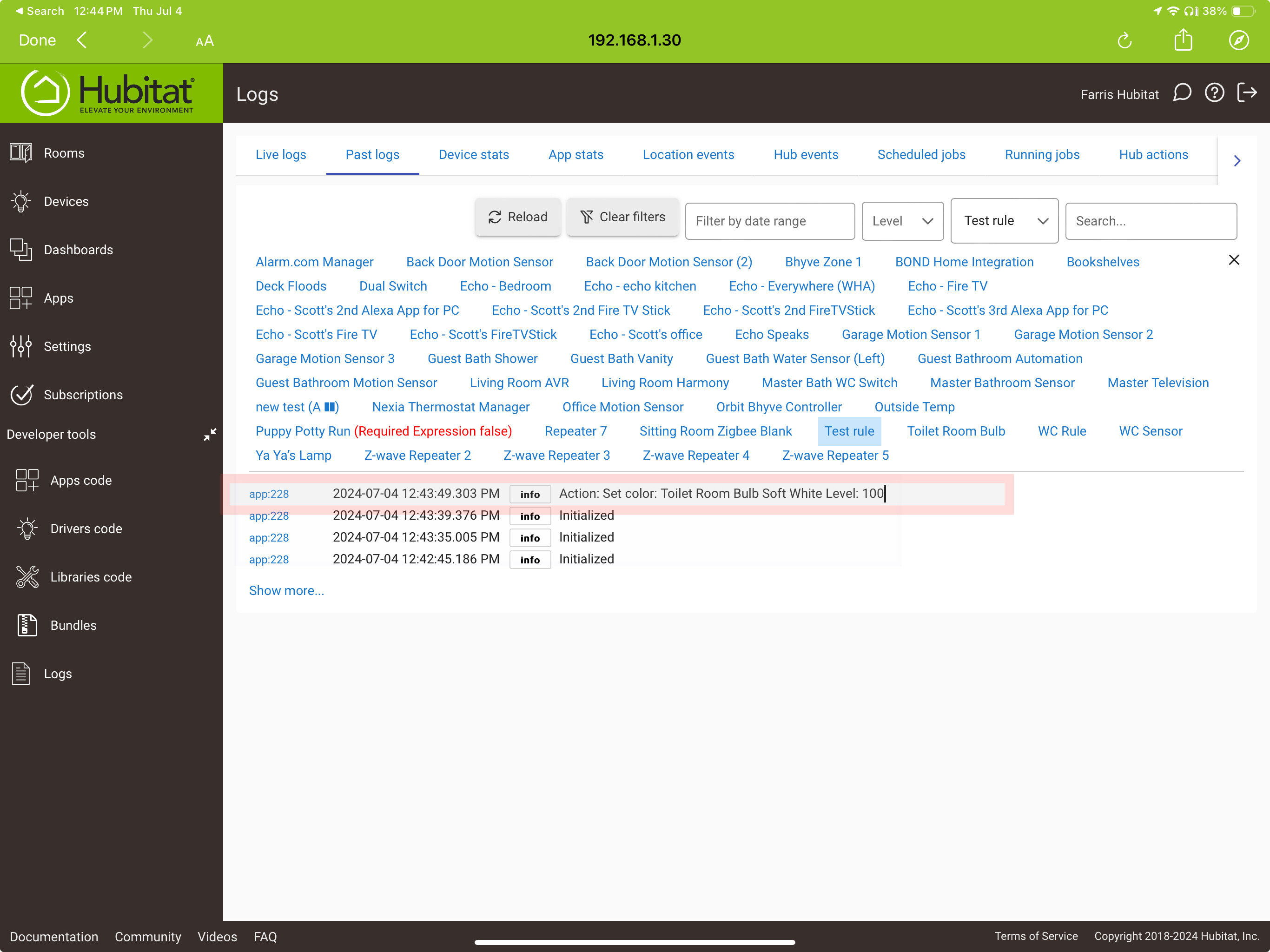

This did not make sense to me because the command was to make the light 100% and Soft White and the logs show the command but nothing comes on.

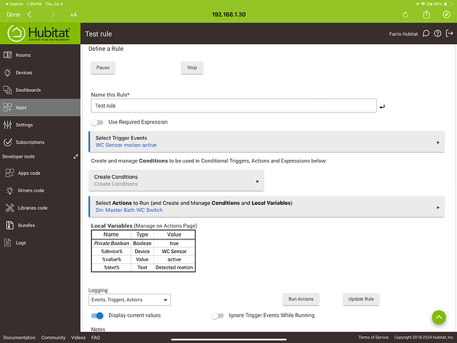

So then I tried this:
This is when the lightbulb went off (no pun intended). I have a Zooz Zen 74 switch that I bought specifically because I wanted to control the Orien - RGBTW Smart Bulb, I didn’t want to spend the money on the Inovelli Red and the Zooz site said this switch would work provided I downloaded the driver, which I did. I am not controlling the switch, I am controlling the bulb but when I try and control the switch there is no provision for a color change. I am able to make it turn off and on but not make a condition that changes the color.
I did try this last test and it came on but still no way to conditionally vary the color.
