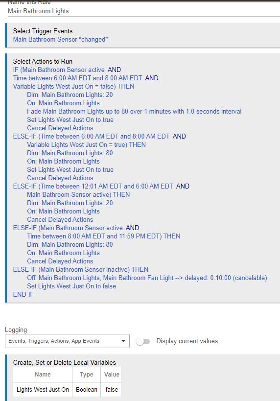

When I walk into my bathroom, it takes 2-5 seconds for the lights to come on. Did I make a mistake here in combining all of my desired actions into a single rule? Can this rule be optimized?
Ideally, motion will trigger:
-lights will come on at 20% early in the morning and slowly increase to 80%.
-if the motion detector can't sense me (b/c I'm in the shower), then if I reactivate the sensor then lights will come back on directly at 80 without having to fade up again from 20 (via the local variable).
-lights come on at 80% during the day
-lights come on at 20% and stay at 20% late at night.
-when motion isn't detected, a 10 minute cancellable timer starts before the lights are turned off.

You only test for motion active in the very first conditional, so the others are going to turn on even if it's inactive.
At a minimum, lose the motion changed trigger and the test on the motion state. Also lose the final ELSE-IF, and all of the Cancel Delayed Actions. Trigger on motion active, and at the end of the long conditional, use Wait for Event: motion inactive, followed by Wait for Event: Time Elapsed 0:10:00. Wait for Events is auto cancelled if the rule is triggered.
Then see what the logs show about time between motion event and lights on event. Turn on action logging in the rule.
