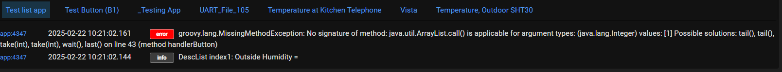

Why does my List require braces when referring to an element?
On the 2nd to last line 'String sData = {DescList(index)} " will not work without the braces. It sends an error:
or
error groovy.lang.MissingMethodException: No signature of method: java.util.ArrayList.call() is applicable for argument types: (java.lang.Integer) values: [1] Possible solutions: tail(), tail(), take(int), take(int), wait(), last() on line 43 (method handlerButton)

However the below does not work. It results in an error (shown in the first screenshot in my original post) hence my frustration.
String sData = DescList[index]
