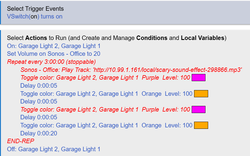

I have two Kasa KL135 bulbs as my two garage lights. I'm working on a Halloween automation which alternates their color from purple to orange. The only way I can get the bulbs to turn orange is to disable the purple commands as shown. I added the delays thinking that might make a difference. With the two purple toggle commands enabled, I never see the bulbs change to orange. Maybe the bulbs need more time to respond?

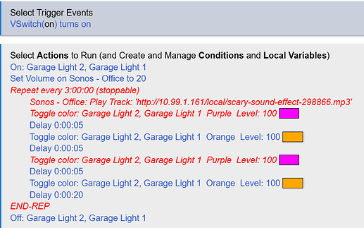

Looking at the rule logs, for some unknown reason rule machine is issuing an "Action: Off" periodically. Not sure why it's doing that, any ideas?
In the screenshots of the rule you posted above, the last Action line (shown) is "Off: Garage Light 2, Garage Light 1"
Oh that's right.
Looks like you need to rewrite your rule.
I’m not sure what exactly the “toggle color” action in rule machine is supposed to do.
“Set color,” which is a different action, has always worked for me when I have incorporated it into rules for RGB lighting.
Using "Set Color" worked! Thanks for your help with this.
