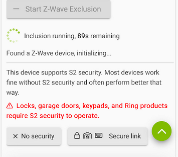

I noticed the warnings about using S2 have been softened but the subtle (maybe not that subtle) message is to NOT use S2 security. Is there a good reason for this? I though S2 was a benefit, not a liability. Something about more rigorous handshaking? Or does using S2 consume CPU resources and slow down response times? It would be good to understand the logic behind the "discouragement".
It does note that things that really need that security will require it. How secure does a simple switch really need to be? I'm just not concerned about someone hacking into my Zwave light switch so they can turn on and off my light, and I can't imagine why anyone would even bother.

Also to pile on with everyone else, that messaging when pairing is outdated and I thought they removed it. I fought to have it changed a while back so at least there has been some improvement. Here is how I see the advantages:
