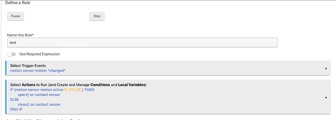

@mavrrick58's suggestion makes the most sense. However, if there is some odd reason that doesn't work for you, a quick and dirty solution might be to create a virtual contact sensor and write a really quick and easy RM rule that opens or closes it based on the motion sensor becoming active or going inactive,
Something like this would probably work.

I will write a rule for it - thank you all for your suggestions.
