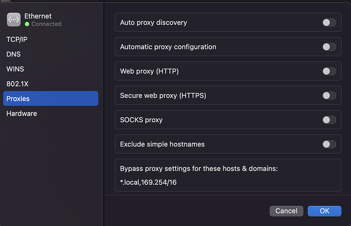

FWIW I only use Safari and have never had a problem accessing my hubitat hubs. Can you ping the hubitats from a terminal window? Do your proxy settings look like this?

Thanks for your reply. I am using my IP address to try to locate hubs but it indicates that none can be found when I do this with safari. I didn’t think that there is anything else unusual when using safari. And proxy settings look identical.
