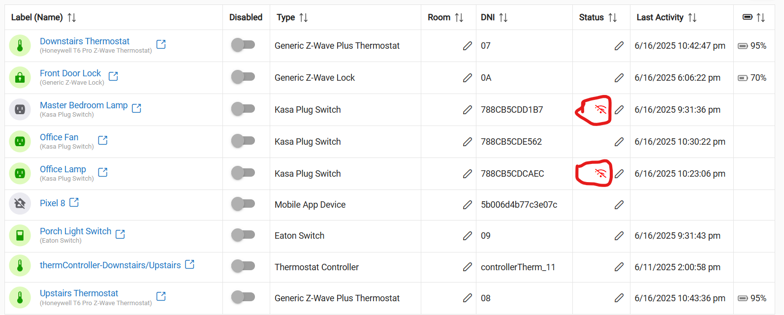

I've had 3 power outages since I setup my Hubitat C8 Pro. When the Hubitat boots up, these same two devices have the red network icon with a line through it as shown in the picture. It says the device is off line, but it works normally. The last time this occurred (during the last power outage) I had to remove then re-add the devices to get rid of the red icon. Is there any other way to resolve this issue with the red network icons?
The feature is broken for Kasa devices brought in through the Kasa Integration app. Best to ignore it. I found that saving preferences is necessary to restore the online status after, e.g. a power outage.

Thank you, saving preferences got rid of the bogus offline status. That's a good thought about the boot order. Maybe next power outage I'll disconnect the Hubitat and after power is restored and my Linksys router is back online, I'll power up the Hubitat. It's simple enough to fixt though.

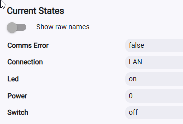

Recommend user open status setting box and select "comms error" as the attribute to display. None of the attributes listed would generate the wifi icon.

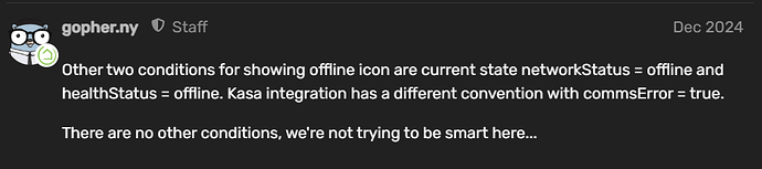

@gopher.ny what drives the wifi icon for Kasa Integration devices ?
Found it (beta forum)
What needs to be successful? After comms error is set to true, no command, however successful, will get it reset to false. I have to save preferences.

It's the commsError value.
