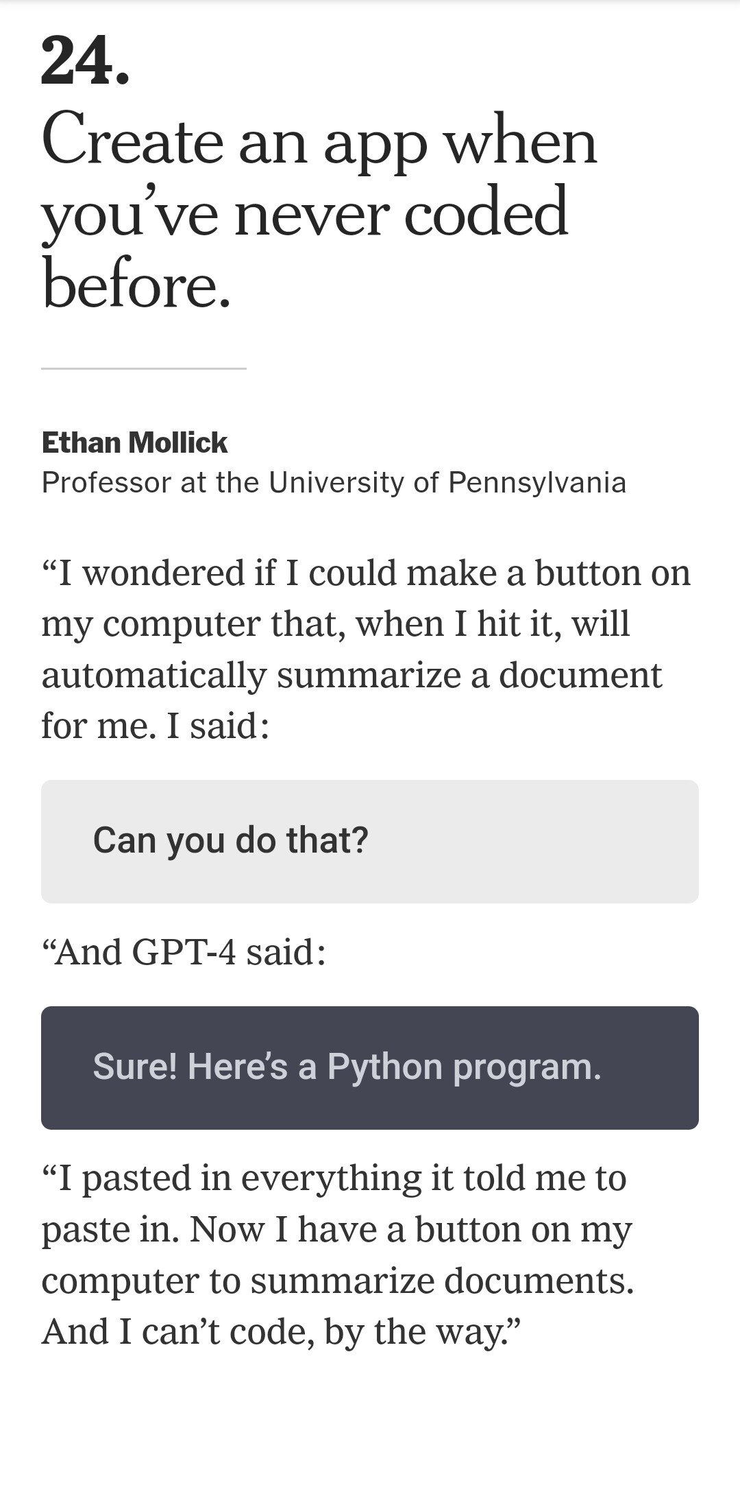

From NYT:

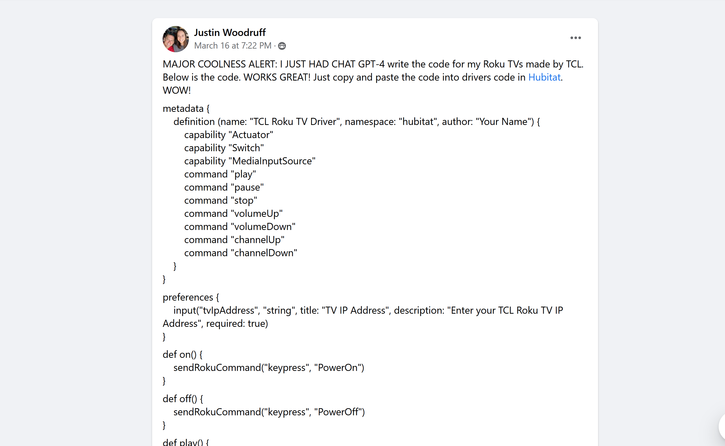

I think it was on the FB group but someone there said chatgpt4 made a roku driver for them (obviously less detailed then @armand driver but functional). I think they just asked it to write it in groovy.
