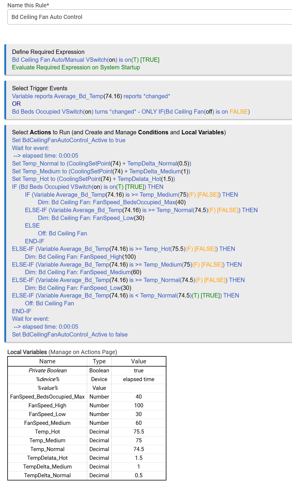

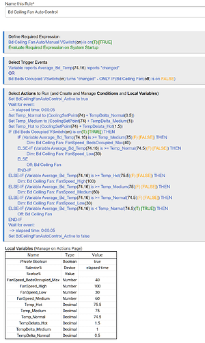

Yes, I am using ONLY canopy module.
I am not sure, I understood your question clearly.
Fan and Light both controlled by canopy module.
For controlling fan speed Dimmer Device pointed to Fan Canopy Module is used in all RM rules. Just in case here is one of my rm rule controlling bedroom fan speed:

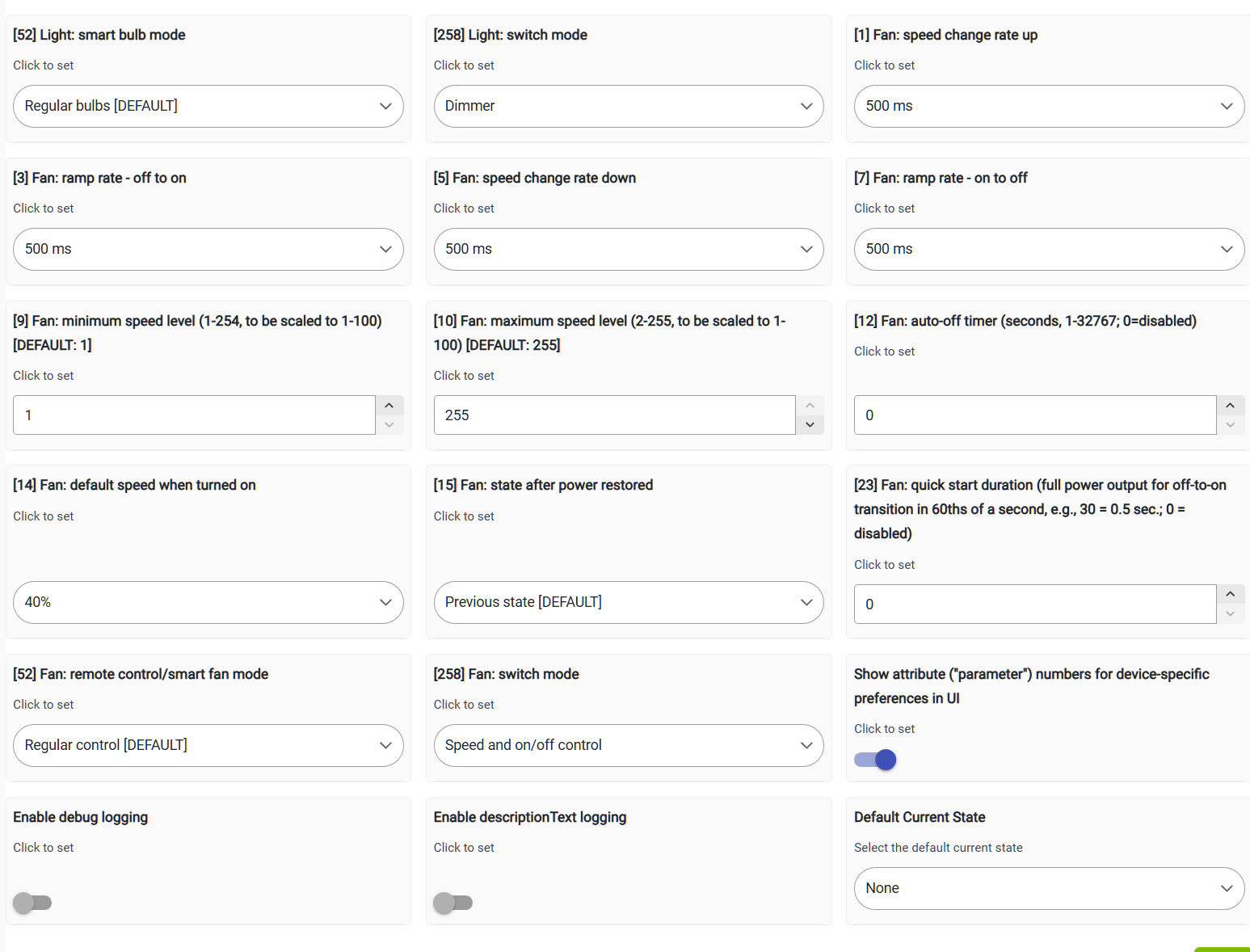

Driver is designed by Robert. Here is a Fan related settings:
Yes, 0-100% like a Dimmer.
