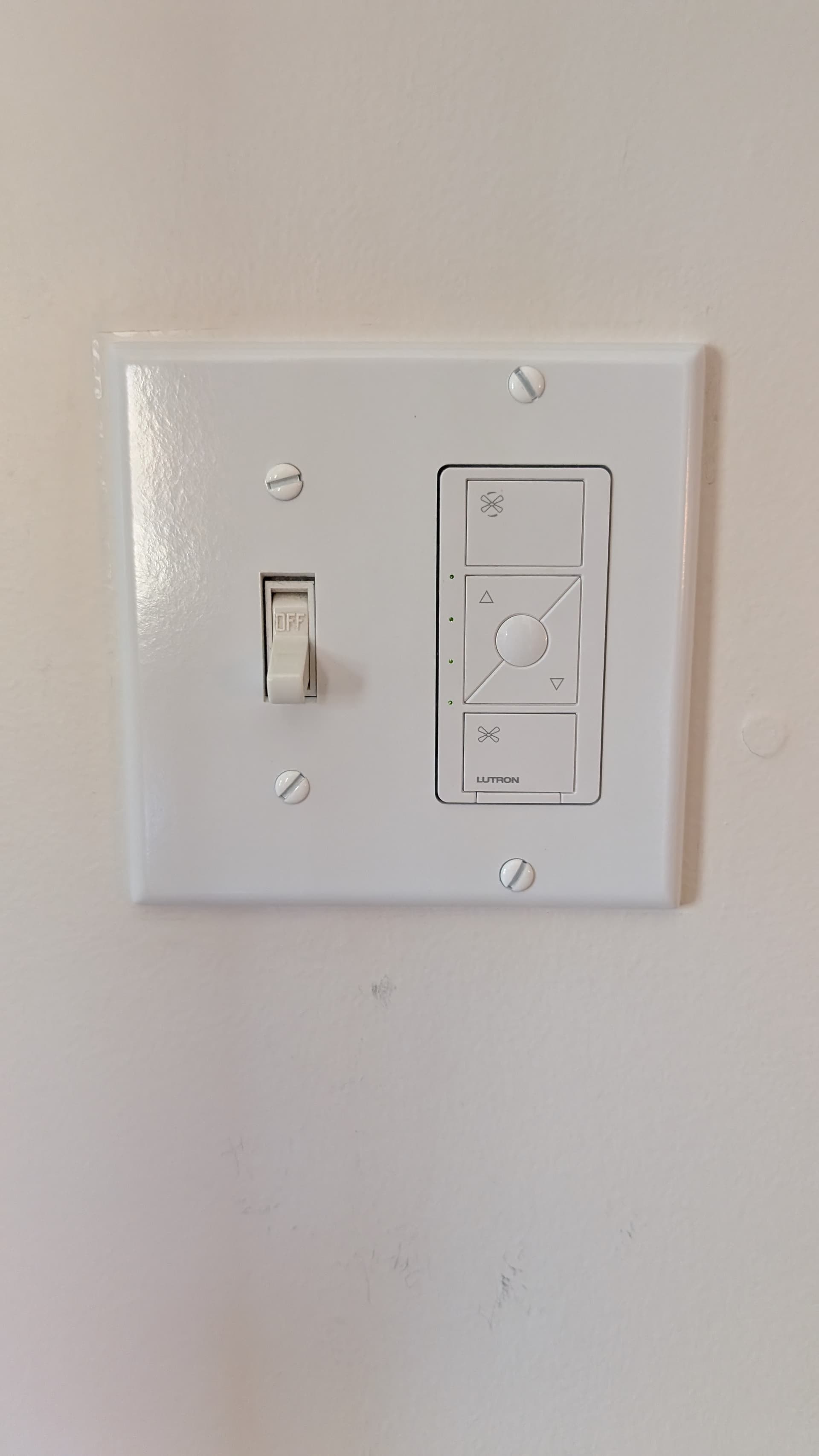

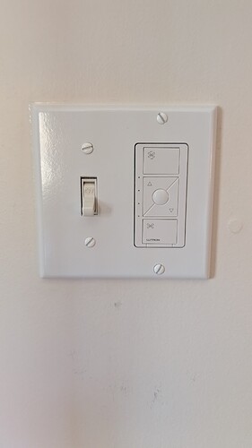

You said you do not use Lutron or Hue. You didn't say you were opposed to Lutron and Hue. The Lutron Fan controller switch for pull chain fans works very well when you have separate light and fan switches. It does require the Lutron Pro2 Hub. It also opens up the world of Pico remotes.
