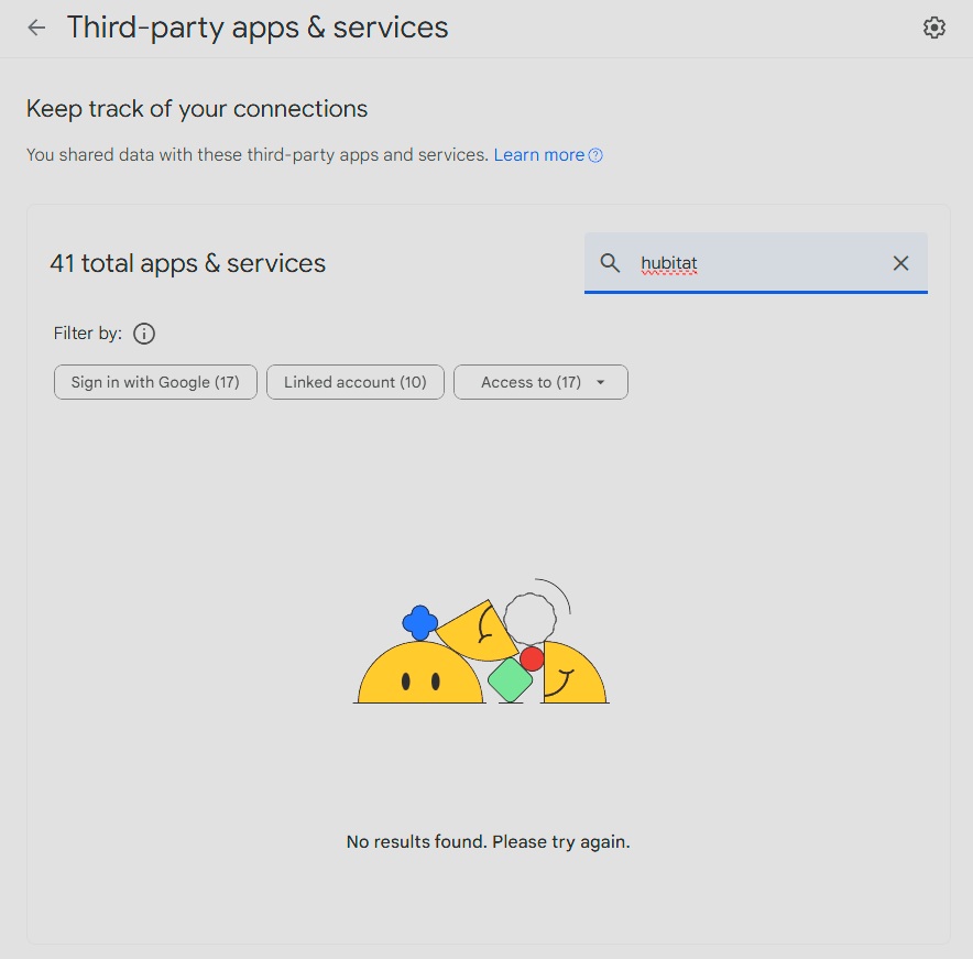

Google's My Account / 3rd Party Apps & Services shows no hubitat account linked (I deleted it)

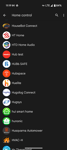

Google Home's +Add > 'Works with Google Home' shows no hubitat available to link (was missing after the upgrade also).

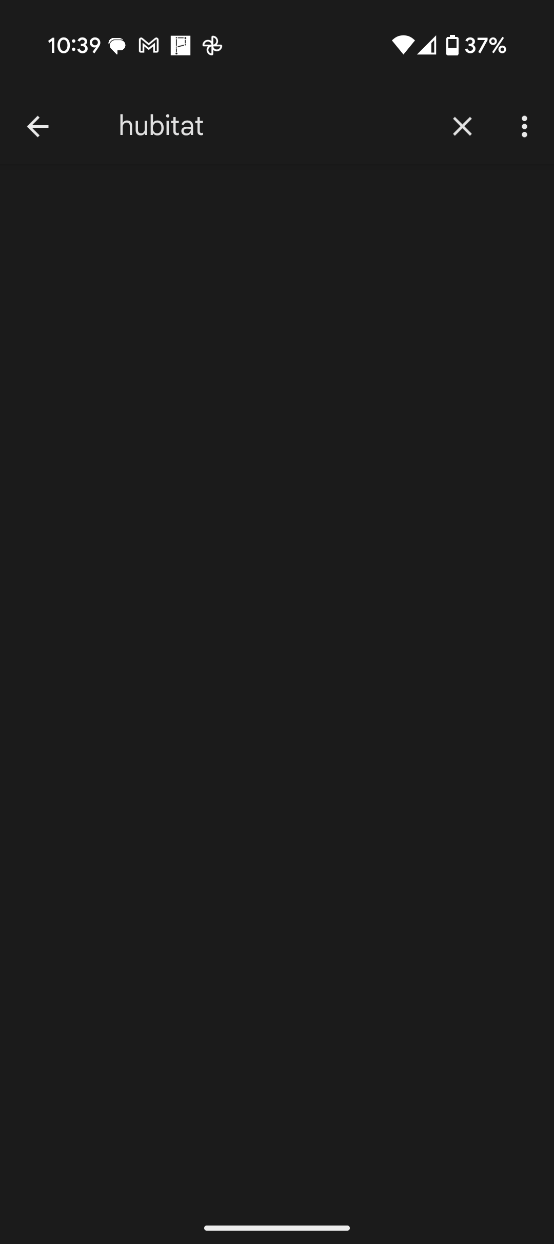

Google Home's +Add > 'Works with Google Home' > search 'hubitat' returns no results.

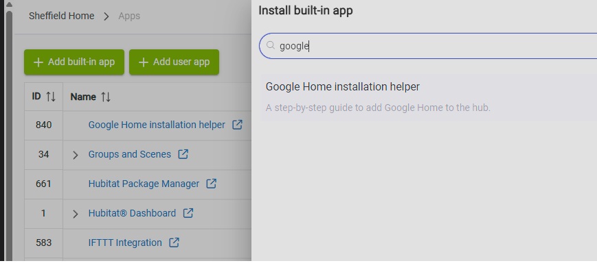

Hubitat's built-in app search shows no Google Home app, other than the helper.

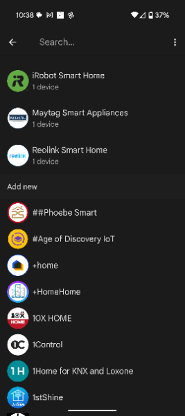

At step 4 there is no Hubitat listed (2nd & 3rd screenshots from the Google Home app).
There is also no built-in app on hubitat called Google Home. I removed it, but can't seem to readd it (screenshot 4).

Best I can think to suggest here would be try an upper-case "H", i.e. Hubitat rather than hubitat, or simply scroll down the long list without trying to filter it.

I just tried this... I had no Google Home app installed. Then I installed the Google Home installation helper app. Then I noticed I had the Google App installed. There is a timestamp in the info for that app, which matches that it was installed just now at the same timestamp as I installed the helper app.
So it appears installing the helper app installs the Google app.
I then uninstalled the help app, and Google Home app remained.

That problem is probably secondary though. I still can't find Hubitat in the list of 'works with Google' integrations. I tried the capital H suggestion, and scrolled through the list. It wasn't listed.
As additional information, it wasn't listed yesterday either as 'connected' or available to link. That was why I deleted the account access from my Google account page hoping to reset things. I also tried clearing data from the Google home app itself.

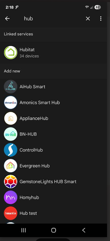

One thing I noticed is that with Hubitat already setup on mine it does not appear in any search results, but from one of your earlier screenshots it does not appear in the list of existing integrations like it does for me.

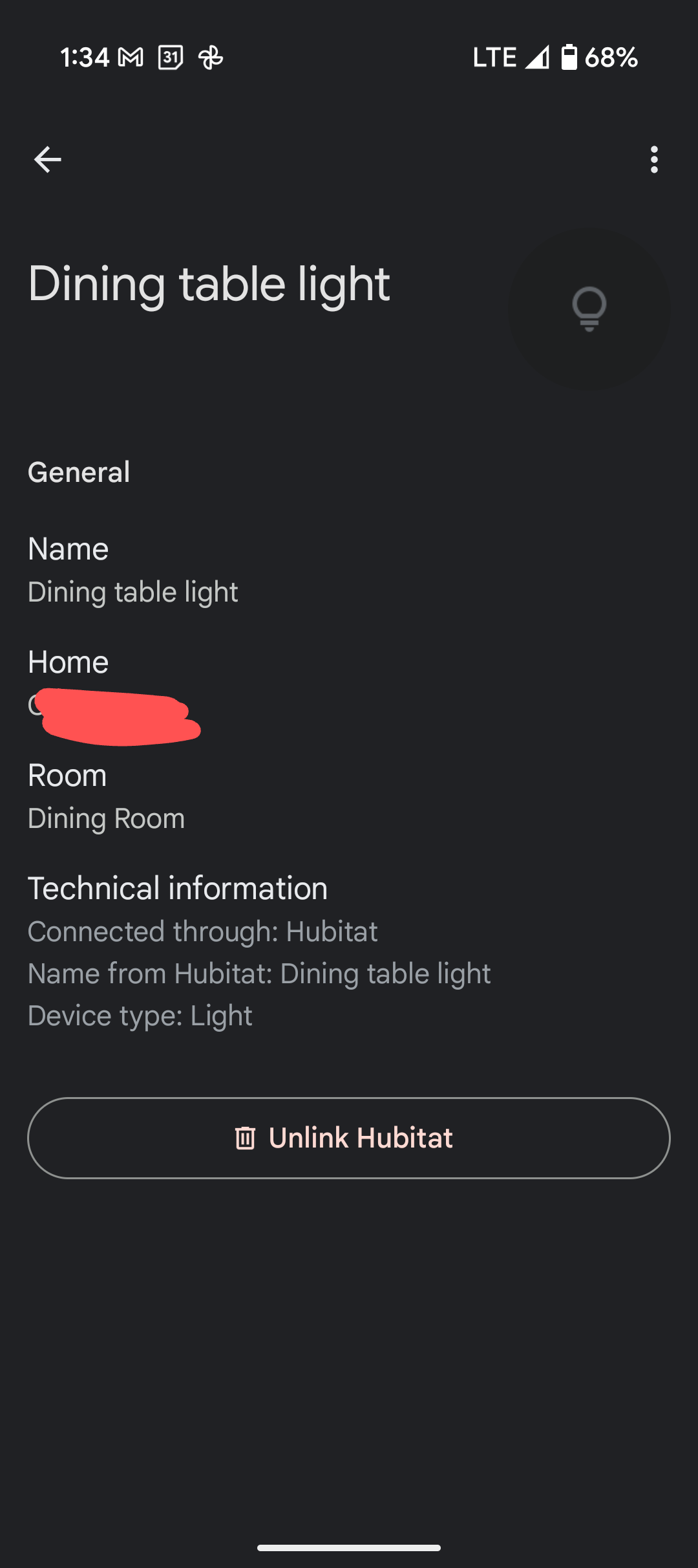

Yes, previously it would appear as installed/linked within Google home. It did not yesterday prior to me removing it, which I found strange.
All of my devices are still listed in home as 'offline', Clicking the unlink hubitat button takes me back to that same 'home control' screen where hubitat is not listed.
I have it installed and was curious. Picked works with google and it shows on mine. Sorry, I know it doesn't help you.
Please ensure you are using the same Google account for your Hubitat & cellphone.If you still can't seem to sort this out, I'd say delete the entire "home" from Google and start over. I'm running 2.4.2.124 and just for fun I ran through the setup again using the Google Helper app in Hubitat and it worked fine.
