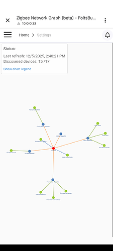

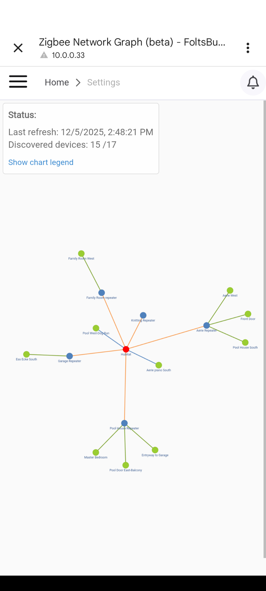

It's a 50x30 foot open space with two stud and drywall walls between it and the hub
found it cheaper, but after describing your space, you may have Zigbee-Wifi coeexistence issues.WiFi channel 1 if possible
https://www.amazon.com/YIFAN-Extender-Amplifier-Compatible-Assistant/dp/B0DLKR81F4/ref=sr_1_3?crid=1UI71YQNFE81Y&dib=eyJ2IjoiMSJ9.645Y0aDw7PIH-oY2cm83z-Hx8-70eQT4RFfKb4-f1tI3lOdBeMLkMvn4PRrfYBXfZO2Gyh_7C-7Ap4BmvHDPLd73MlMM8qndgxrnXwKwCevo5ynHhTYkrhAWgV6bXH7IQR4DSDfIB7WSSk1oydpEKpulCNYW9fOzxPV9EgKJoqlF4b6IxMPCLwz3V5hifB3ns82K75mSENgIFyhhU_aZMZb0j-PZOywLcTm1cGJGjgzN38Tc5ic_t968N437K38_51Mm4xBBqRJwajFEoZA_A86eqLolQgzKnwtyh-YGihw.9dVU_y9mRYuKypmx1joyY9Z3xHoZbRBYAX7FcE0byJM&dib_tag=se&keywords=tuya%2Brepeater&qid=1764630180&s=electronics&sprefix=tuya%2Brepeater%2Celectronics%2C72&sr=1-3&th=1

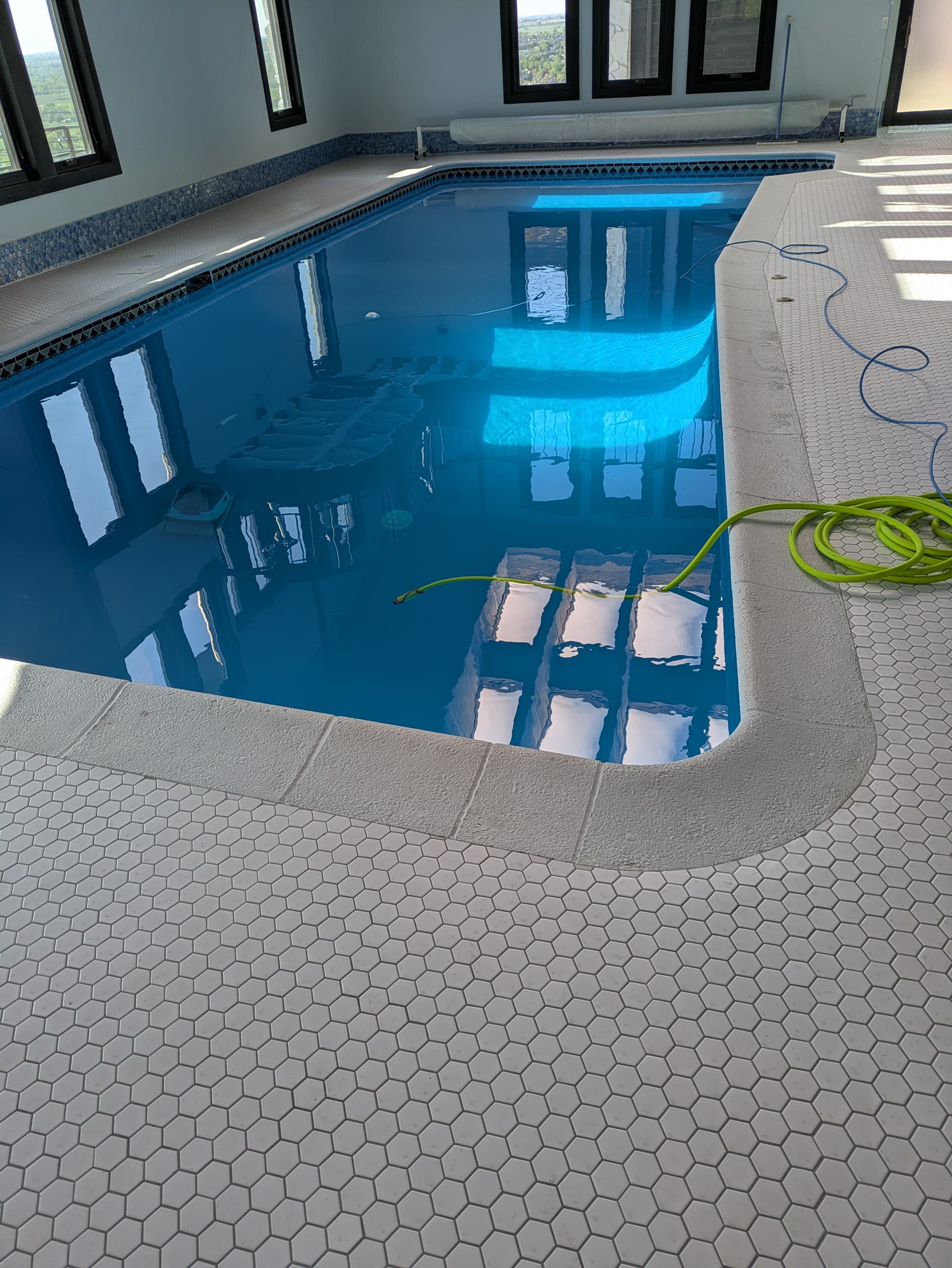

Got an Aeotec repeater with 9 dB of gain for the clear space in the Pool room
The plugs should cover the room with five windows, and a plug on the garage for an outer access door
I have a wifi extender in the pool house but those use a channel 1 sideband link to the router....
I may need to move the hub away from the nighthawk router to the upper level of the house
Nice setup for seniors or therapy pool. I see your ceiling leak.
Leak fixed a couple years ago... Good eye... Now I need 11 new skylights and competent people to build and install them
Pretty much Cadillac'in at this point... Re-Connected all Contact Sensors and they got on with business via the installed repeaters, mostly...
