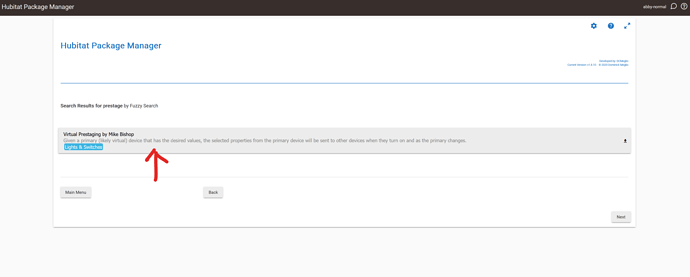

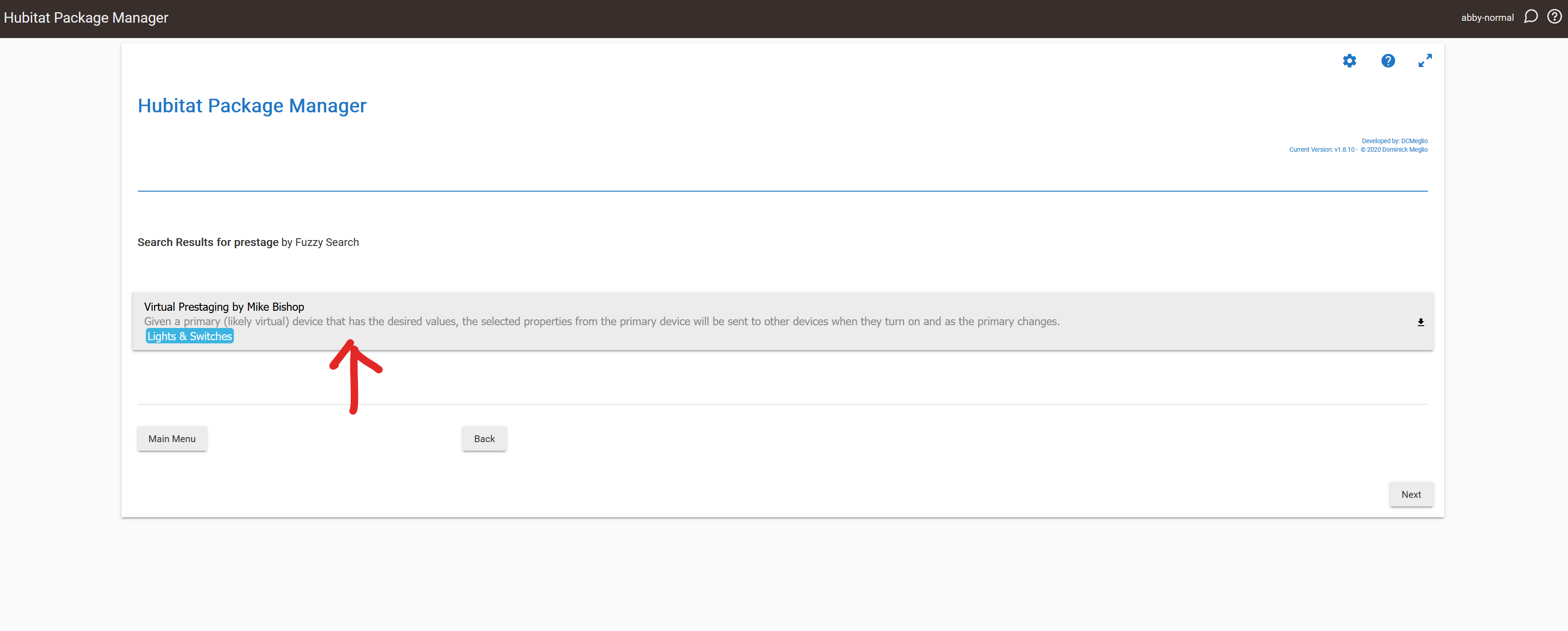

Yes, you can set the level/color for a light before turning on. Just create a rule. Though since your new, you might look at @mbishop 's Virtual presaging app.
Thx, still didn’t work
