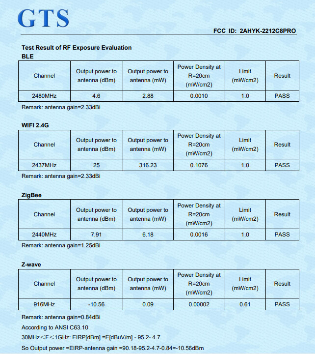

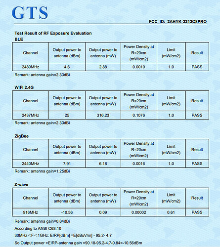

My understanding was that while there is Bluetooth component in the hub for Matter commissioning, it could not be used with just a firmware update to enable Bluetooth device connectivity.
Someone on Reddit says it has a full functioning radio, and that 2.2.4 firmware will enable it for expanded uses. They pointed to this FCC doc:
https://fcc.report/FCC-ID/2AHYK-2212C8PRO/6921502
This contradicts what I have read in this forum, saying it could never be used as a full functioning radio. So which is it?
The C-8 Pro has a Bluetooth radio and will be used to connect Bluetooth devices starting with the next release.

Yes, apparently not. I'm currently using HA with a long range USB Bluetooth dongle on the PI4 that runs HA, to bring Bluetooth devices into Hubitat with HADB. I really don't see that changing, since I don't imagine the existing Hub Bluetooth radio will have much range for devices without a dedicated antenna.
BT uses the same frequency range as zigbee. If I had to guess, those radios could possibly share an antenna.
What does the FCC report indicate?
WiFi/BT appear to be a single module that share an antenna. Looks like it is also replaceable should the BT range prove unsatisfactory.
