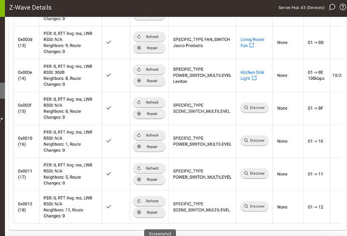

Attached is a screenshot of my Z-Wave details page. It looks like I have some "Ghost Devices," but I cannot remove them even after following all the steps. Adding Z-wave devices should not be this difficult. I am having no issues Including my Zigbee devices. Any help would be appreciated and Thank you in Advance!

What helps me with stubborn devices, even new ones out of the box, is a factory reset to defaults. Check that a previous pairing attempt did not leave a ghost on the z-wave details pages.
Factory resets were done. Like I said it should not be this difficult. If I can include it on the C5, why not the C8? You would think a much newer model would be more effective and efficient. This should not be so cumbersome.
It is most likely because of the ghosts. You need to get rid of them before you can add any more devices.
I mentioned I can’t remove the ghosts. I followed the “ghost” removal steps and I refreshed each Ghost device 3-5 times and still can’t get the remove button to come up to remove them. I did get one ghost device to show the remove button but when I clicked it, the ghost device won’t remove. Any suggestions on how else to remove these devices?
Power down all z-wave devices and try them again.
If you're having problems removing the ghosts you will need a z-wave stick to remove them.
This needs to be your first priority, until removed adding new devices will be an issue. As others mentioned you may need a Z-stick. I know it's a PITA, but I have been though this myself and many others.
