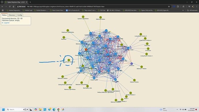

Or maybee not fiqured out. All these window sensors are Sengled E1D-G73. They all work fine except for the one that is marked. It gets no messages in zigbee settings and will not report open or closed changes even tho it always shows up in the zigbee map app. They never will report if they pair up to my enbrighton 43084 switches or my enbrighton 43096 plug in dimmers or enbrighton43094 plug in switches. Everything else pairs and reports fine, it is only the Sengled E1D-G73's if they pair to the Jasco Enbrighton. Anyone got an answer?
