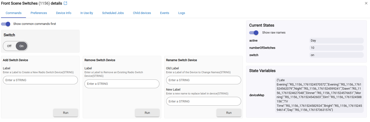

Here is an example device created for my Front Scene Switches, with ten child virtual switches.
Just add both files to drivers code, then create the parent device with the Radio Group Switches Driver. Use the command in the parent to create the child devices. (note: state values only update on the driver page when the device page is reloaded, so the state map will not show new devices until parent device is reloaded).

Edit: Note, the parent device itself is also a switch. When it is on, it controls the radio group, when it is turned off, it will not do group updates. So it should be left on, unless for some reason you want to disable the radio group function so the switches work independently, in which case turn the parent device off.
