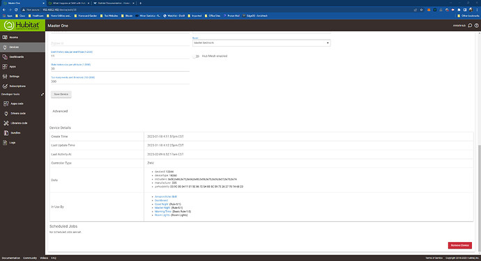

I found this under my settings as the HUB does a daily backup at 3:01AM but it also does a DATABASE Cleanup. what does that entail? I think this is what maybe trigger the issue. can someone from Hubitat advise.
Screenshot 2023-02-08 171336
During the backup any corruption present getting into the backup is cleaned out (same thing happens when you download a backup) and the file is stored on the hubitat and/or cloud (cloud if you have hub protect). That wouldn't affect lights though.
very odd that it correlates to the time exactly is there a possibility that when the database is overwritten could it trigger a device status update which can cause the device to turn on?
So change the time and see if your bulb tracks :smiley:

IT has happened AGAIN but this time prior to the issue here is what happened I changed the DATABASE clean time to 8:01 PM guess when the light turned on. thats right 8:01 PM. and guess what there are NO events. NONE but the light is now on and under device events it still shows the light as OFF. one thing that did happen though this light was unplugged yesterday and I plugged it back in last night. not sure what occurs when the light reconnects to the ZWAVE network. but what ever it is causes an issue when the DATABASE clean up occurs. I need someone more technical to advise me on this. seems like a coding issue. I have not made any requests to turn it off as it still is in its current on state. not sure if there is any data I can collect or provide but someone on Hubitats team needs to help me.
Could you post a screenshot of your complete Zwave Details page please?
