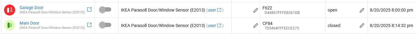

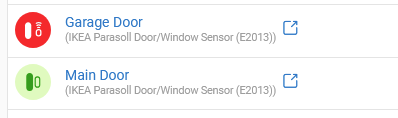

What does the red icon in devices mean and why is it different for the same device.
The device is IKEA Parasoll.

One is open and one is closed.
Thank you, but both doors are closed.
The icons on the device page to do not refresh often (perhaps never). Reload the page from the browser controls. Better yet, click the device name and see what the devices page says.
I think the device is bad, even thought closed, it is reporting open.
The contacts are 5 millimeters apart.
I deleted the device and added again, fixed the issue. Thank you.
