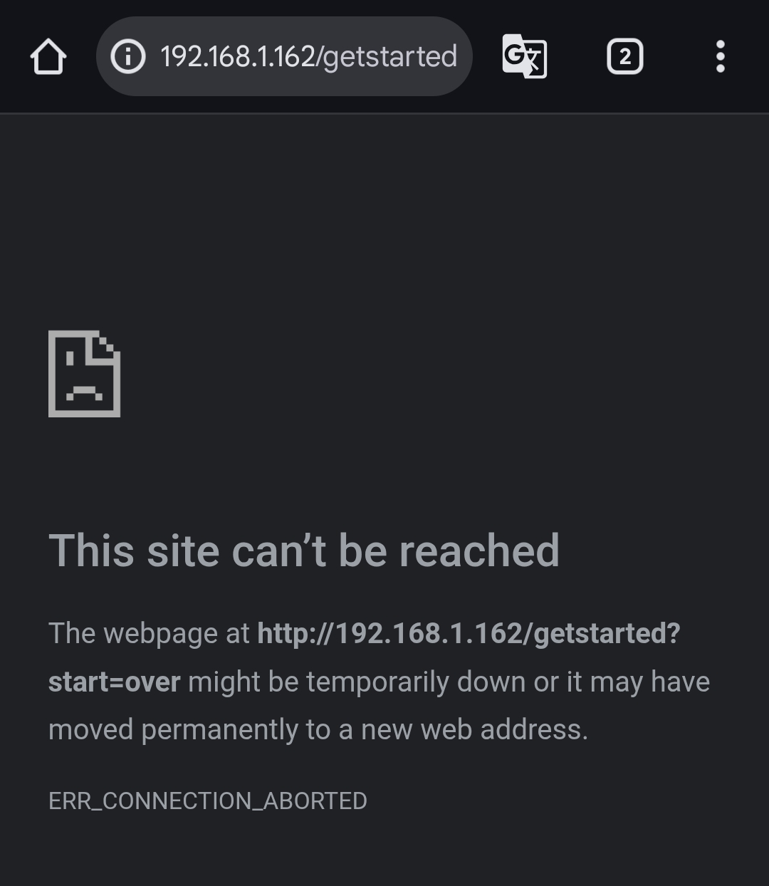

I am a new user and just starting to boot up my new C8 Pro. However, after discovery and hitting the "my new hub" link that presents, I get nothing. Well, a new tab is created and it appears it is trying to connect to the IP address of the newly discovered hub but it just spins and spins and spins forever. I have reinitiating the process several times with no change. If I let it spin long enough I will finally get a "this site can't be reached" message.

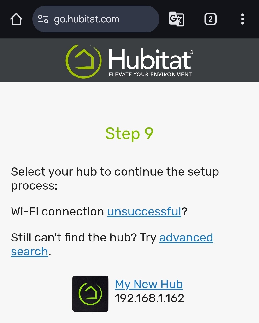

Quick Update for Anyone Encountering Similar Issues
The "My New Hub" link will only appear during setup after the hub has been successfully discovered on the local network:

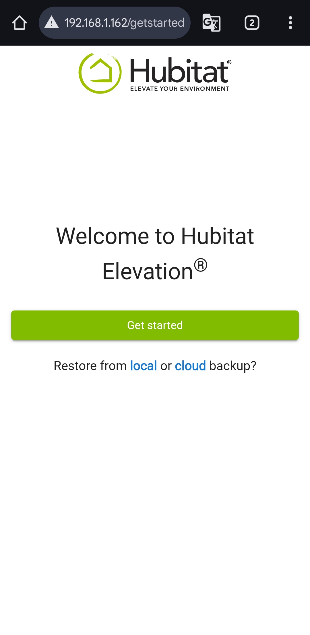

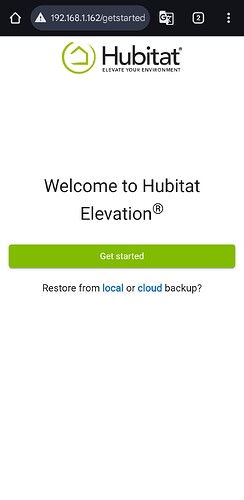

Clicking the link should open the local getstarted page, after the hub is updated to the latest platform version:
If, for some reason the mobile device gets disconnected from the local network, or the same 2.4ghz network that the hub was setup, then following the "My New Hub" link would result in the "getstarted" page timing out:
If this happens, try the following troubleshooting steps:
