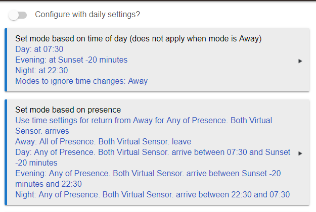

Just as a matter of interest, here is a screenshot of my settings.
BTW I use a virtual presence sensor to save having to go into Mode manager to change things. I use rules to set my virtual presence sensor but that is not really relevant for this query.

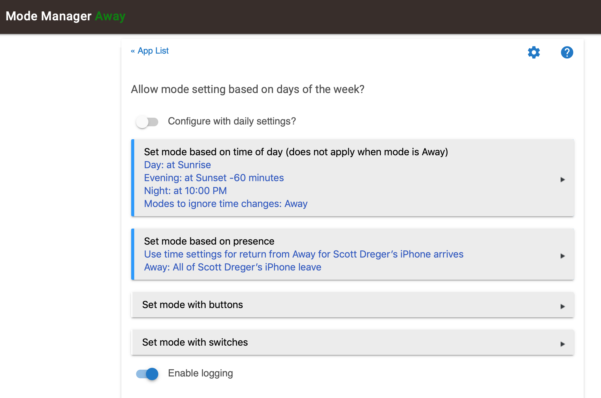

Same thing is happening tonight ... it switched to Away successfully when I went to work, but failed to switch back when I came home. According to my iPhone app, I'm smack dab in the middle of my geofence area.

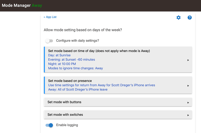

Here's a screenshot of my Mode Manager settings.
Your mode manager looks t
OK to me.
Can you go into your events for your phone and see if your phone changed from not present to present?
