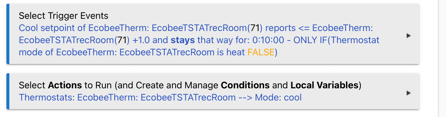

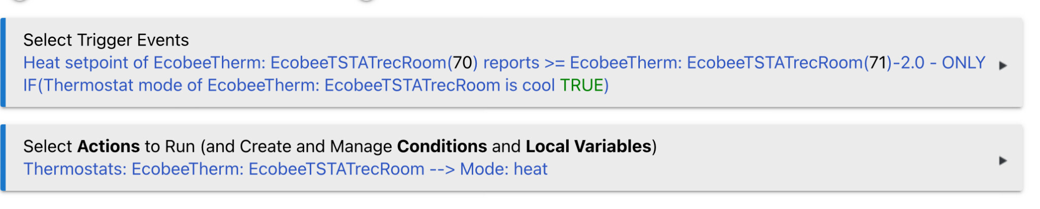

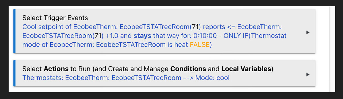

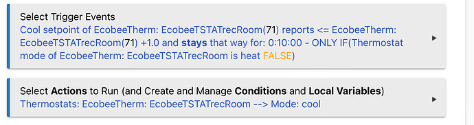

. This is a sample. Thanks!
So, if the current trigger is TRUE, then it will need to change to FALSE and the. Back to TRUE before the actions will run again. A trigger must change to TRUE for the actions to be run.
While developing a rule, you can always manually run the actions to test them, in case it is difficult to force the trigger to become true.
Hubitat is an event driven hub. The triggers subscribe to the device events, which are sent out whenever an attribute is updated in a device. So, the rules do not check if they should run, they are basically just sitting there waiting to respond to an incoming event they are subscribed to.
Aren’t temp changes considered events?
Of course they are. But the condition you have set for the trigger to function ensures it will work once and only once - as explained by @ogiewon above. Essentially when the rule triggers, the condition becomes false by virtue of the actions of that rule.
To get a second temperature change to work as a trigger, you need that condition to become true again.
Yes, you could create a rule that is triggered if temperature changes by more than 2% or something like that, or if it just changed at all.
When it triggers, it becomes false because the state change in the mode brings about what are somewhat reciprocal setpoints in the stat.
Then a sibling rule acts similarly to flip the mode back when appropriate.
It is looking like it works as intended, just with more delay than I expected to see. I put in an intentional delay now to avoid any chatter that could occur, and they work fine together.
