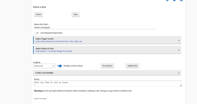

@sclera2002 I'll also chime in. When using hubitat you're tying things together. Z-wave, zigbee, clear connect (lutron), some wifi devices. If you want more than just light switches (lets say light bulbs in a table lamp that can't be controlled by switches) or motion sensors, or contact sensors you will need Hubitat. For something as simple as unlocking my front door either via presence sensor (located in my glove box) or by keypad or even physical key, that then turns on certain lights in the house so I'm not looking for a switch, requires something that can process that rule. That rule looks like this. I also have a secondary notification that broadcasts on the speaker Welcome Home %whomeverunlockedthedoor% But as said, if you just want to control a few switches then you don't need Hubitat.
