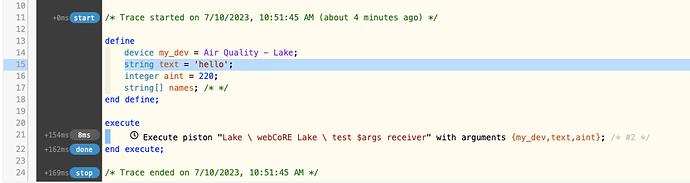

You can pass $args for this if you are calling the piston directly.

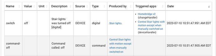

@gopher.ny is there a way for an app to see in the event "Produced by" or "Triggered apps"
Otherwise in the device, there are events of the commands that were run against the device
Here is the sender

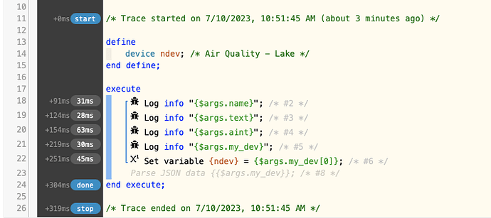

Here is the receiver
Does it pass the calling piston name. I don't do an Execute Piston, it only changes a switch from off to on and that triggers another piston? I want to see the piston name that changed the switch.
It only passes the arg you initialize in the Execute Piston function.
I have set my arg to the name of the calling piston.
