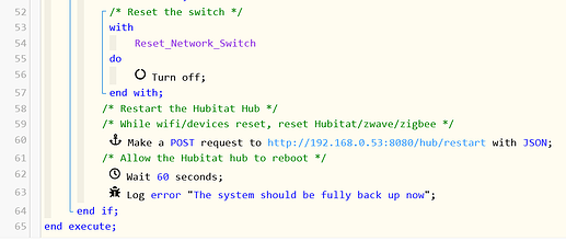

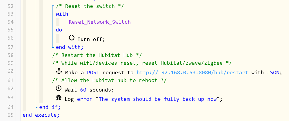

Valid point. Technically, not the last thing. Here is the end of my piston. I was just curious if the final wait and log command pick up after the hub reboots. As suggested, I could just run a test piston to see what happens.
I don't know what webCoRE does internally for this, but the most likely option (and what I would do if I were writing such an app) is a scheduled job, technically created via runIn(). Contrary to popular belief, these survive hub reboots, and the job will be executed if the hub is running at the scheduled time -- no matter what happened in between (except, of course, for something else deleting the job).
However, you're only giving the hub 60 seconds to reboot. That seems pretty quick (although I really only reboot for updates, so I've probably never paid much attention otherwise...). While it may depend on what model you have and what you have on it, I'd maybe give it a few minutes just to be sure. For initial testing, you can go even longer and see if that scheduled job is still there (check the App Status page for the piston, or "Scheduled Jobs" in "Logs" for a different view of the same data) after the reboot. This matters because as I mentioned above, the hub needs to be up at the scheduled time (no giant game of catch-up for anything missed). But that's generally the only concern, other than ones people might create themselves from whatever their rules, pistons, etc. depend on.
