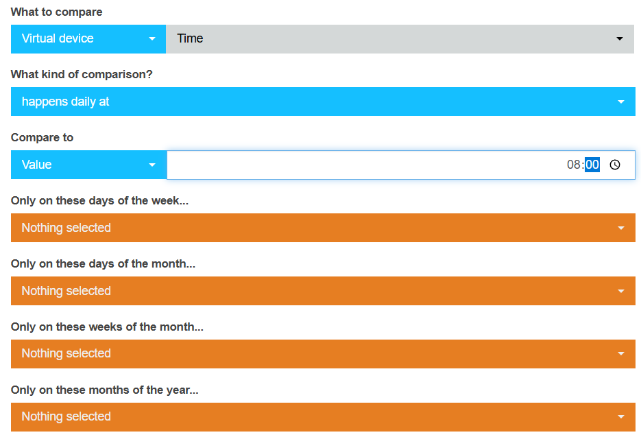

When you select happens daily at, you should also see all these options.

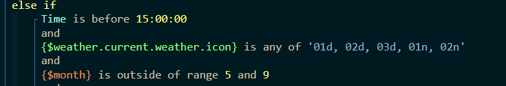

Something like this?
Does this work for a list of numbers (days)?
I would think you can just change the weather device to $days and the hex numbers I have are really just a simple list you could change to 1,3,5,7 etc.
You could change $day to a string and then check if it is NOT any of your days.
I put it in a timer just to test it.
Edit: I was thinking you need a variable for day string, but you don't, so I removed it
That works. So simple. Just could not get the syntax correct. Thanks.
What was was getting me at first was no option for "is not any of" for $day, then I realized the options given are based on the variable type, so if $day is a string those options come up.
