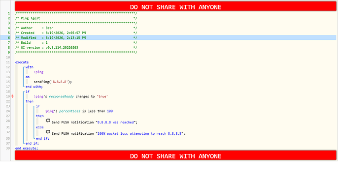

If you want to use the ping device this piston should let you use it to detect 8.8.8.8
