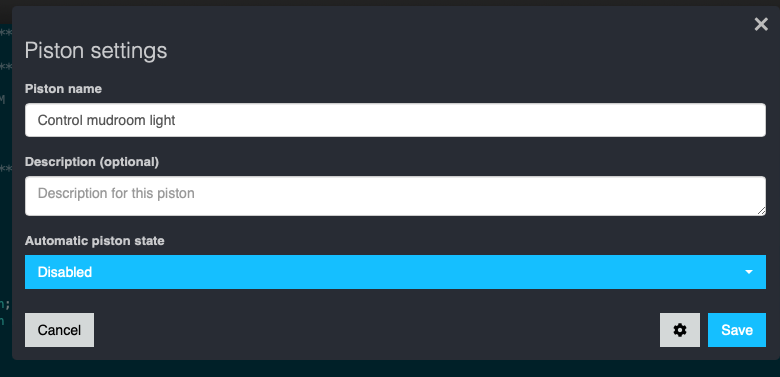

Where can I activate it?
Edit a piston
Make sure you can see settings (or enable under options):
go to settings at top
Hit settings gear
Fill in command execute delay to 50 or 100 ms.
Save piston

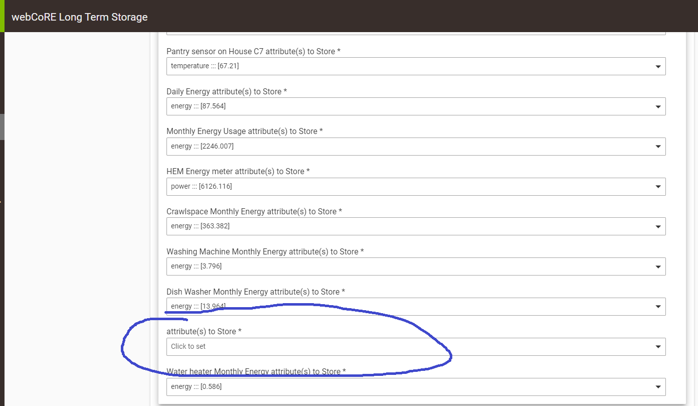

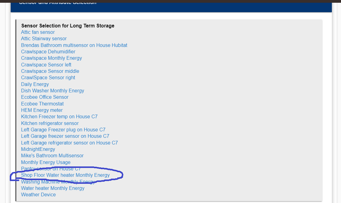

@nh.schottfam, Having an issue with LTS.
I saw this before, but it was with the last version before your released. After I updated it went away so I didn't report, but now I am seeing it again.
I just added a new sensor to LTS. See screenshot 1. In screenshot 2 it shows a added sensor but does not list the name. It is a virtual omni sensor.

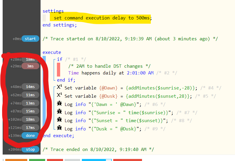

the other had no delay set, so I put 100ms. However, one that was giving me issues had alreadya 500ms delay set and was fixed with the "log full". I increased to 600ms for this one. let me see what happens.

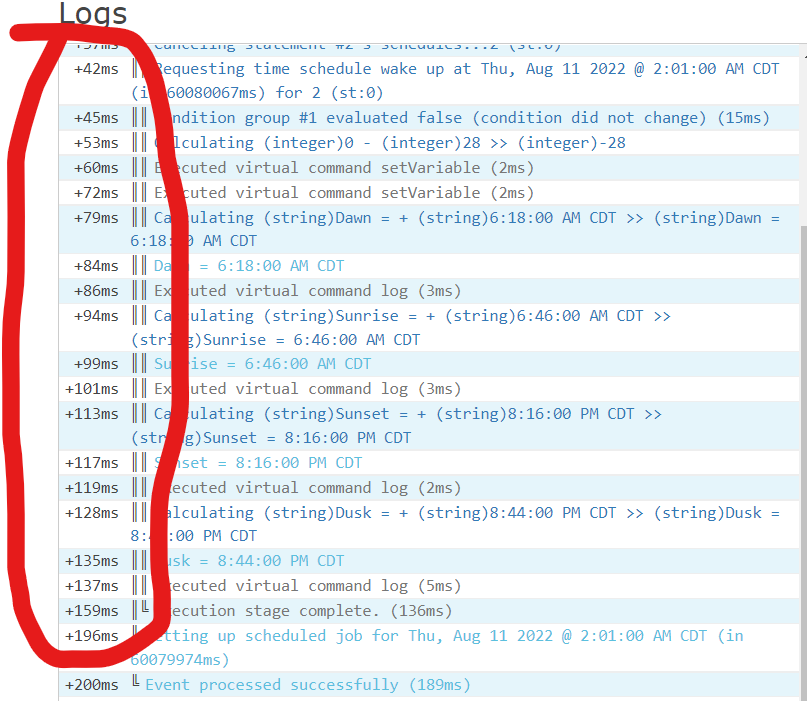

As far as I can tell, the command execution delay is broken. This is from looking at the timestamps in the log. With an execution delay set in the piston settings, there is no additional delay between command timestamps and there is no log entry for a delayed execution (there used to be)
Commands are things sent to devices. none of those are device commands.
ahhh yes, that makes sense. I just randomly picked a piston to test :blush:
