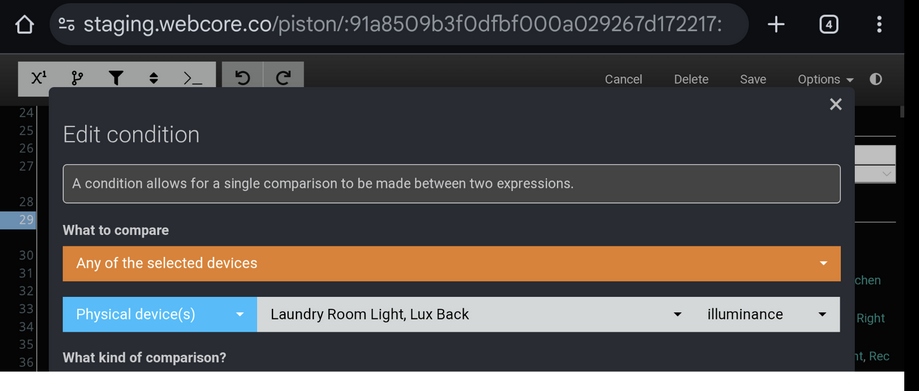

Using my phone to work on pistons is now hampered. I can't access a drop down menu to set device variables.
@nh.schottfam
Confirming the above report.
I'm finding the random insert of devices when editing on my cell phone in Chrome.
Every time I edit the device it randomly fills in other devices instead of dropping down.
Edits fine on the PC in staging.
Exactly it.

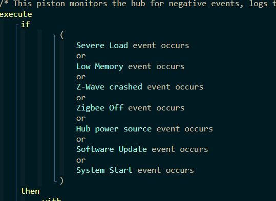

Are any of these events currently supported?
I only get one message and that's on the System Start.
Most of them are very rare but I would expect Software Update to work every time I get a new beta.
Yes, They are all supported.
I have individual notifications setup for each & they work (except for software update, I don't have that 1 setup).
Ok.
I didn't expect, or want the others, they are bad news.
I did want software update as I beta test and would like to know when a release is available.
This won't do that -- it subscribes to the "update" location event (as you can see on the Logs tab of your hub), which will tell you when the hub restarts for the first time after a new version has been installed. There is no location event for an update just being available, though I think some third-party solutions like the Hub Info Driver can detect this for you if you want some automation, such as a webCore piston, to be able to use that data.
Ah.
Did you mean Hub Events?
I get this one fine on boot but indeed I see no other events like Update Available. :frowning:
Oh well. Not a big deal.
Yeah, sorry, it's under "Hub Events." But yes, there is none for update available.
@ipaterson Has this got anything to do with the issue I've reported?
Works on android browser chrome in "desktop mode", but not under standard mobile browser mode.
Summary
I'm seeing the same with Chrome browser on my Pixel 10 XL.
