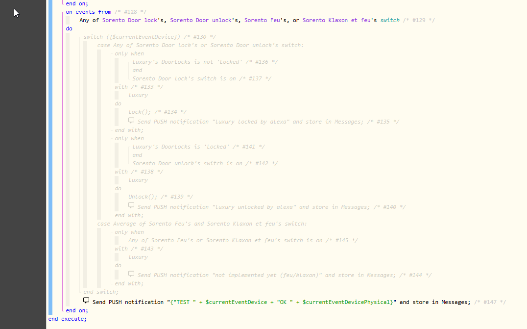

I just realized that one of my event is not firing and its a simple one! I remove everything exept a notification... When I flip the switch nothing happen, the event not trigger.

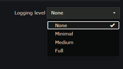

What do you get if you turn on Full Logging?
Have you turned on Text Logs for these devices and made sure they are all generating logs?

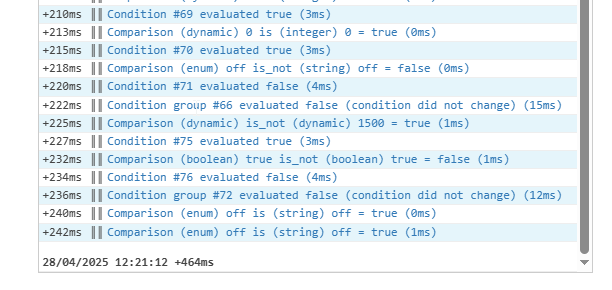

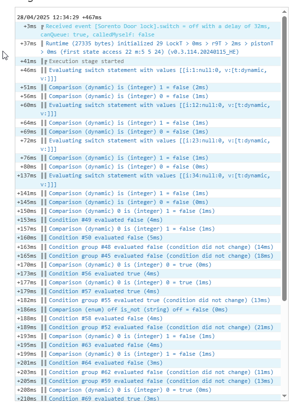

I get only this, like the piston see the switch flip but not the event if I see the right thing...
The logs don't really match the trace numbers in your piston so get confused, c'est dommage.

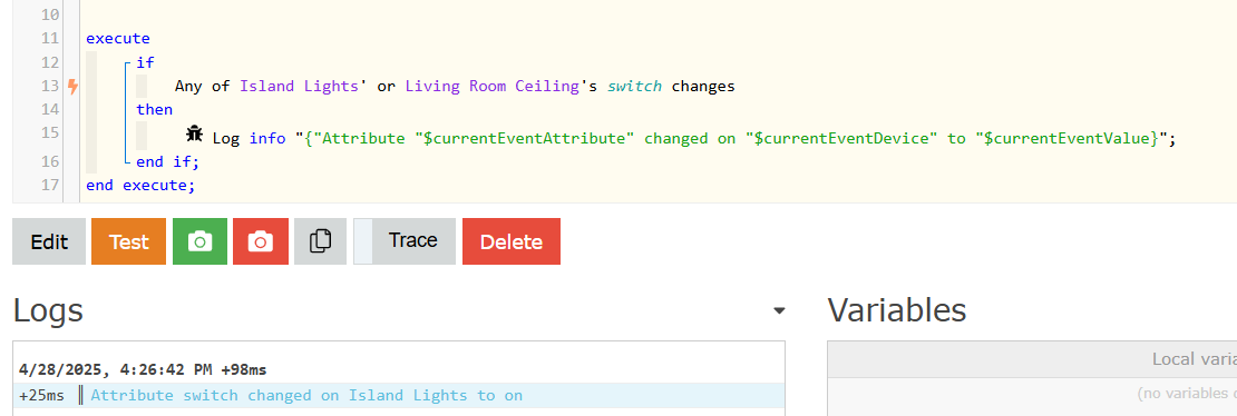

Try creating a test piston with "If [devices list] changes (changes to) " and do the Push Notification with the logging on Full.
It will be clearer in the logs to see the basic structure work.
When I debug I create the simplest piston to find the problem.

Have you tried just using an IF instead, to subscribe to changes, instead of using "on events from?"
That was my initial post. :wink:

I'm not sure with the greyed out portions vs. non greyed out, perhaps post a green snapshot?
  • ie in what you saved did you have statements disabled?
  • ie I agree with comment on what you showed for piston and logs do not seem to match

I could test with if statment but when I can I use event because its isolated from the rest of the piston. With if stament the piston run each time and evaluate all data... and sometimes it cause event cancellation and other problem.
