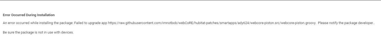

I tried using "repair" on HPM and it gave me this:
one of the solutions was
"I’m not sure on the fatal error part.
You might want to do
reboot (like you did)
wait a few mins
manually update the webcore piston file"
It didn't work for me.

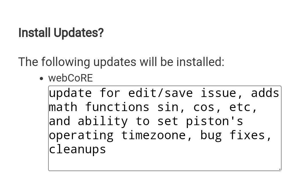

They just released an update which mentions the issue
