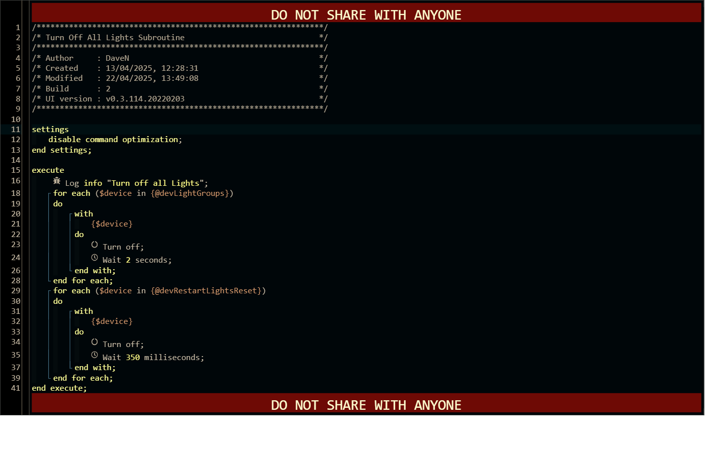

I Execute a piston from my System Start called Turn off all Lights.
I have the flag to wait for execution to complete as True.
That piston should take about 20 seconds (see below) but the System Start keeps on executing lines after 1 second - Speaker Group init.

It says right in the yellow warning banner on the Execute Piston dialogue box that a wait or pause used in the callee piston will cause the caller piston to just continue. You have a two second wait in your device loop, so it returns as soon as it hits the wait.
So it looks like it returns on the first pass through the loop, as soon as the first device turns off and then it hits the wait statement.
I'll reread the warning.
I just focused in the fact it had to be in the same instance.
