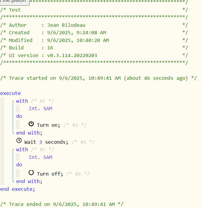

I'm running webcore on latest release, I also did a repair (on a C-8 Pro V2.4.3.107). Since few days webcore did not send all commands that are working fine in the hubitat device. The power on works in HE and webcore but the power off works only in HE. Webcore does not send the power off command. The problem occurs on all my Innovelli LZE31-SN. In a piston I did ON, delay 3secs and OFF. Turn on works but in see in the log the off is not sent.

Also in your piston above you can streamline it by putting the wait 3 secs and the off directly under the on command.

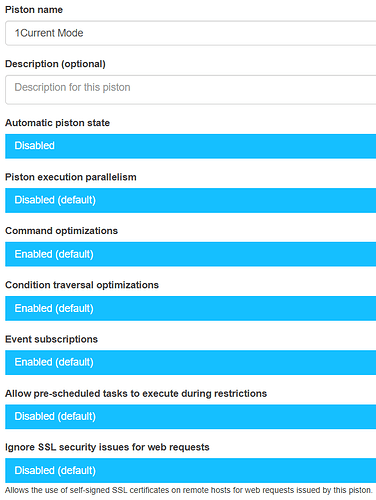

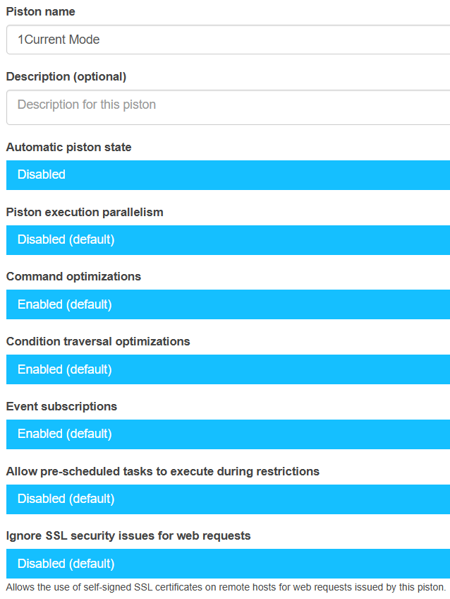

If you open the piston and click on the piston name, you will be presented with a number of options.
Command optimization is the one you want.
