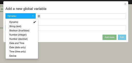

Can I make a global array variable like @Music_Songs_Array?
Does not appear to be an option.
Yeah, that would be nice but it is not possible.

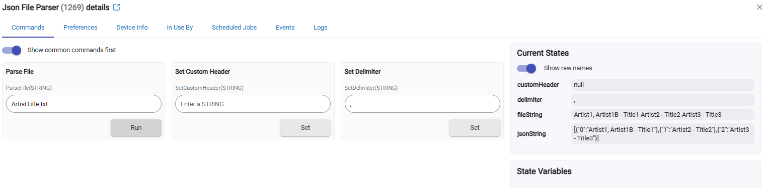

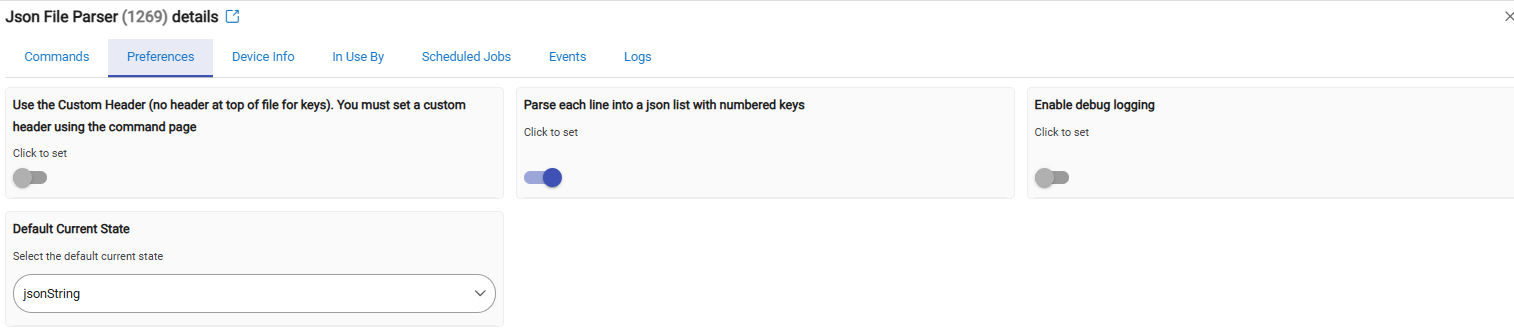

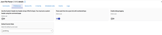

I added the preference to Parse each line into a list, so select that and save:

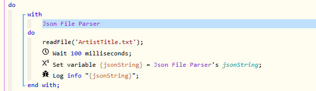

I put the file name in the Parse File command, and it parses it out to the string loaded from file manager and the json conversion
Now, you could just copy and paste the jsonString into a global variable.
On the Webcore side, you can just parse JSON data on the global variable. You could also just get the string attribute from the parser if you share the device with Webcore:
Wherever the string comes from, use the Webcore Parse Json Data to create $json.

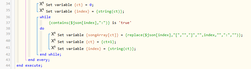

You can also put it back into an array in Webcore by using a character index:

replace($json[0],"[","","]","","0","",":","")
