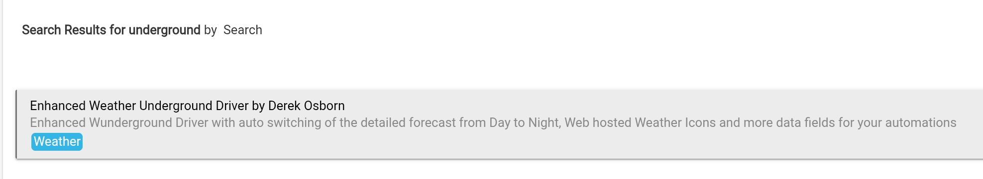

I saw that, but it was overkill for what I needed. I really just needed rain percent and rain inches for today and the next three days, to use with my irrigation app. So I had AI make a driver for that, but it does also pull in most current conditions as well.
I can paste it back into AI and have it add any additional attributes if needed.
