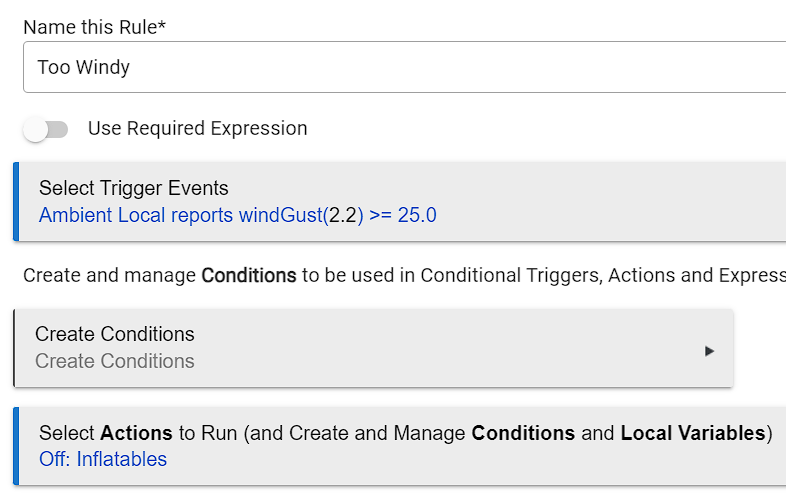

One of the first rules I made was watching my Ambient/Ecowitt driver for wind gusts so that I could shut off our Christmas inflatables if it got too windy. It was originally via their API only but once Ecowitt's GW1000 became available local support was added for that and then local mode for the Ambient directly. The API is pretty irrelevant nowadays versus getting the data directly.

Are you still using this? I had never thought of that, but that would be a great idea! If you dont mind, I would love to see it.

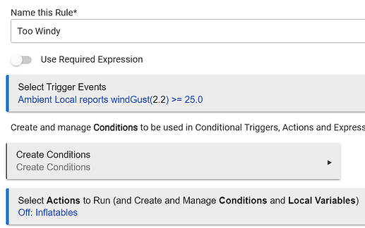

Here is the very simple Rule I use.
I have no idea why I never realized i could do something like this! Thanks!
That happens all the time to me. But this particular Rule was one of the first things I did when coming to Hubitat because it was something I had wanted to do on my previous system but could not.
