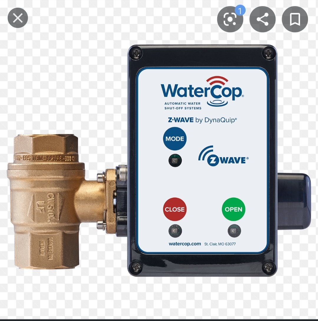

Trying to move my Watercop valve over to HE. I've ecluded it from ST, and then did an exlusion from HE and the valve is blinking as it should when ready to include. I've tried about 10-15 inclusion runs and it just ain't happening.
The valve is about 6' from a Zwave repeater (through one wall) the repeater (Eva Logik plug) is then five feet from a Zwave wall switch, which has two more Zwave switches on the other side of that same wall, and then more switches in the family room several feet away, etc. So there is plenty of Zwave mojo around.
Hub is about 15-20' away through 1 wall and a window (I moved it as close as I could w/the current length ethernet cable I have).
Aside from getting the crazy long ethernet cable so I can put the hub on top of the watercop valve, any suggestions?
I'm going to run a Zwave repair, reboot, and then try again to see if that has any effect.
It paired up easily to my SmartThings hub using the same configuration of zwave repeater and in-wall switches, etc., so I know it can do it.

Yeah, sorry, forgot to include that. C7 w/2.2.3.119.
Did the zwave repair, it completed w/out any issues. Rebooted.
Still unable to include the Watercop.
Mine went fast and easy. C7 fully updated.
When it’s ready for inclusion 4 blinks?
You can remove the actuator from the valve to move it closer.
Yeah, it's been four-blinking for the last couple hours.
Damn, looked at this again and I do remember that it comes off.

Moved the hub to about 8' away from the valve (much easier to move hub than remove the valve) and tried to pair w/the valve actuator mode light blinking four times quickly. No joy, just like last night, no reaction/inclusion.
Unplugged and plugged the valve back in, started inclusion, touched the mode button once, and BOOM, joined like it was dying to be a part of the team.
So maybe last night all my failures were that the valve wasn't really trying to join, even w/the four blink happening...the reboot and single touch on mode did it.

Oh man. You didn’t press the button on the valve?
Yeah the button will join or exclude depending if the hub is in join or exclude.
