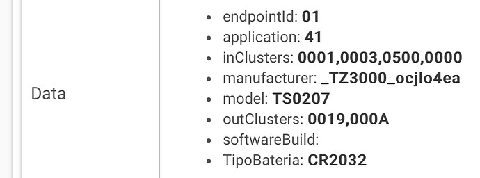

I have this water sensor that I bought at AliExpress around a year ago.
It works ok, but erroneous reports the battery value to 200.
I have tried with different drivers and the one that works best is this one,
And the values I get on the device page are the following ones,
Is there a solution for this?
Edit: all other drivers that I have tried reported the same battery 200 value.

I have some important information that might be useful.
I have another water sensor that is physically identical but doesn’t behave as the other one mentioned.
Here are the data I have from the second one.
(I only have two)
And here are the values I get from this one,
I know this might be confusing.
Please let me know if you need any particular information from either one.
